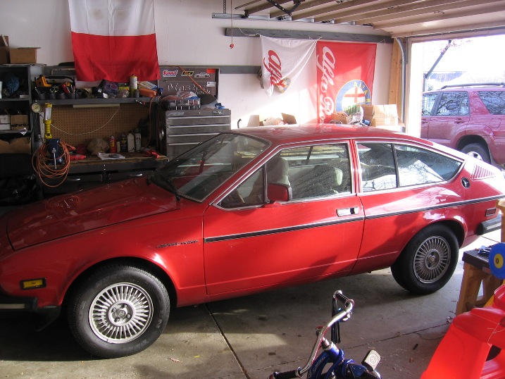

Just got delivered today. Of course, snowing, icy and 10 degrees outside...battery dead. Jumped with some ether and she started right up.
Some issues like small missing parts in the interior, box of goodies in trunk included gauge surrounds, plenty of little screws, and other items she shed over the last 32 years.
All the original manuals including service coupon book and some receipts still in car!
Carpet almost new. some dried rubber, etc
Looks like a repaint but still in very nice shape. Looks like new windshield, not one mark on it!

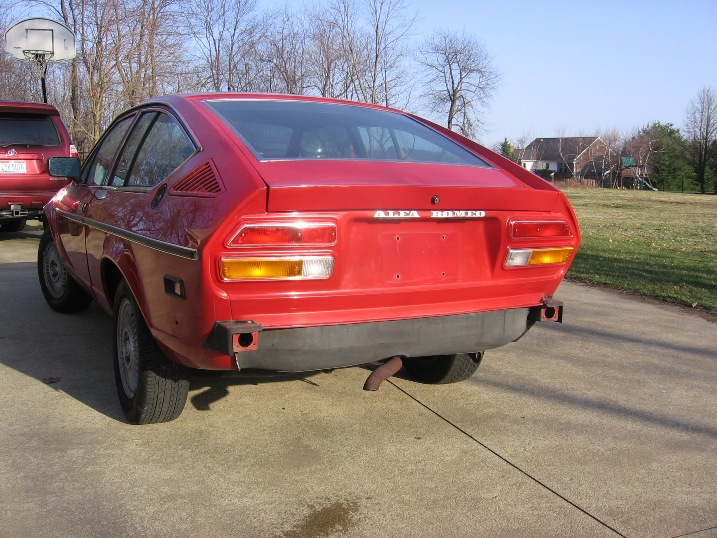

Re: XRAD'S ALFETTA

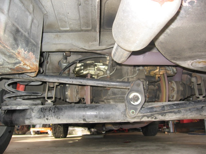

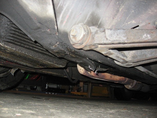

some salt dust on car from the last 30 miles of drive, uncovered shipping. rest of transport from cali was covered otherwise would have been real mess.
PO left some oversized wiring dgms, which will be helpful, they measure about 30in long!
I won a set of slightly used 11.1mm cams from ebay. engine runs like a champ with no noise. even w/stethescope touching all parts of block and head. Needs oil change ASAP.

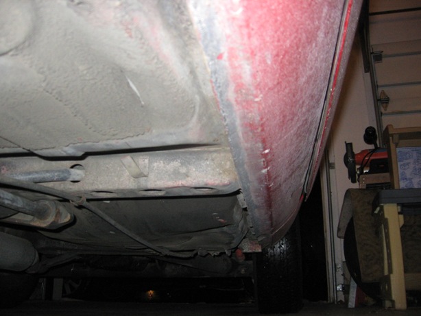

ooops, small explosion in frame?!?!?!? have to weld that together..looks like something was ripped out of there..maybe oil pan guard or tow hooks...???
Original hood padding decided to crap out on the engine as soon as I opened the hood. someone glued it to the hood in one corner....DOH
someone wired up the headlight switch to a dash switch so that will have to be addressed.
everything looks real good for 30+ years!

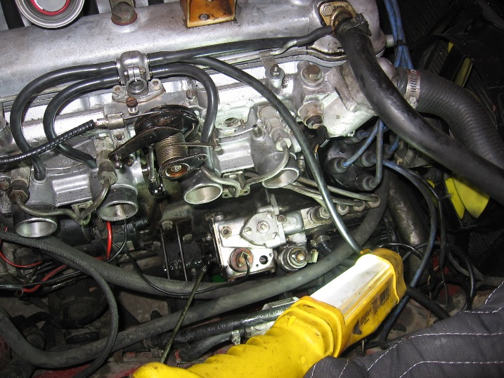

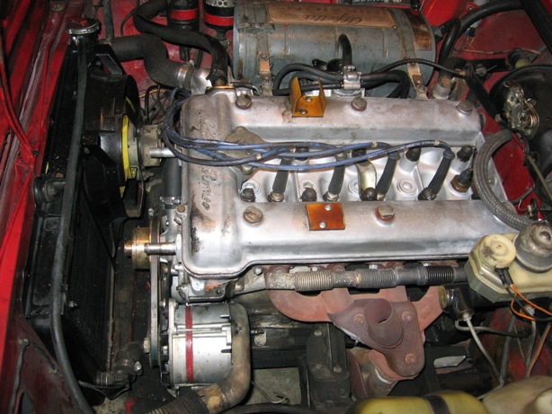

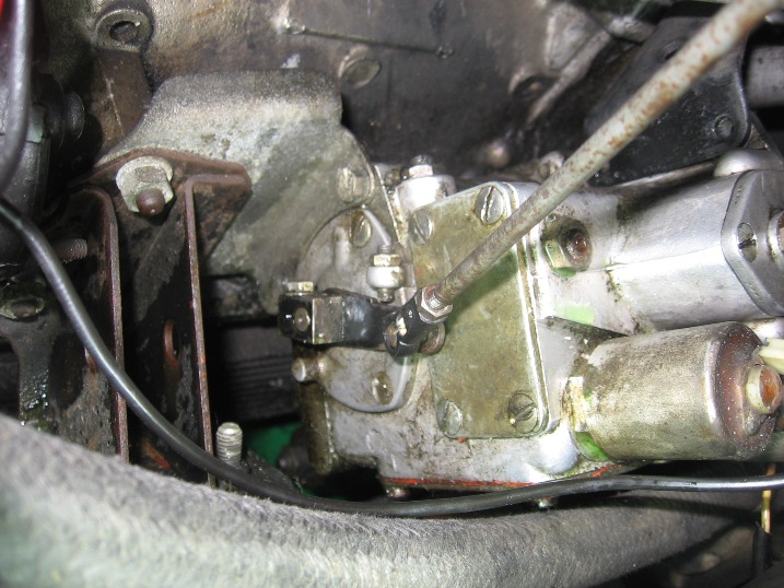

Ok so alfetta decided to never start again and I did the whole spica tuning, clip and spring check etc...
Findings: Two copper washers a spacers for TA. I can see why someone put them in there as the TA hot/cold change was 10mm, but the screw depth was not at 29mm. BUT, everything else was out of whack like:
1) the throttle plate settings too closed
2) throttle set screws for min and max not correct(actually, the throttle plates were closed but the throttle mechanism was NOT hitting the stop screw...gap of about 4mm!)
3) Throttle cable too loose
4) short throttle rod used to set the idle and therefore not correct length
5) Long rod to SPICA wrong length
6) TA depth way off so car running real rich (black soot out exhaust and on my driveway)
7) Leaking upper TA mount (missing O ring, and two messed up hold down screws/nuts)
idle adjustment had hard nylon washer in place and really whistled (of course, can;t adjust it, so that had to be replaced)
Good news:
1) TA throws 10mm at 180 degrees adn retracts all the way
2) Cold start solenoid works
3) Fuel cut off solenoid works
4) fuel pump works
Once all the above items reset, she fired right up and revved like a champ! NO sooty exhaust. Interestingly, althought the TA set screw depth was not exactly 28-29mm, once all the other things fixed, the final control arm gap was correct and she ran great..so I don;t reallyy care to mess with it any more.
Really revs nicely and cuts off without backfire. No bad noises from engine..needs oil change ASAP. Have to fix tinly pin hole radiator leak (which seems to go away when hot)
Some metal high pitched disc like ringing from mid and rear driveshaft..need to fix.
Anyway, enjoy the rev vid:
http://www.youtube.com/watch?v=zh8nSCpQ_rM

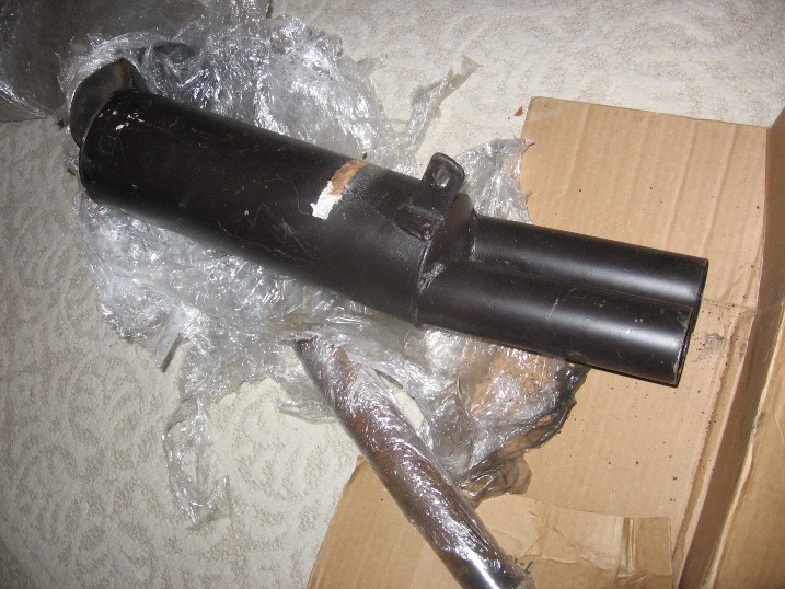

Just picked up a NICE ansa exhaust, barely used, from Alfabb member.
really nice twin tip unit. Used and painted, but still solid!
ooops...maybe I should get it off the carpet before...too late, wife sees it..

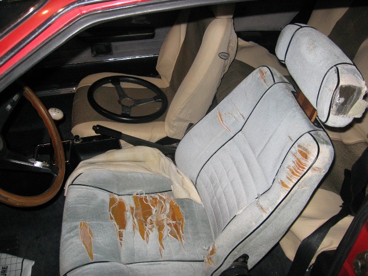

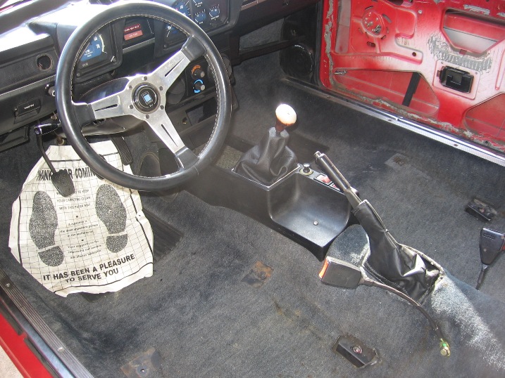

Finally some time to work on the car:
Nardi wheel installed with adaptor. Got the wheel from a guy in JApan on ebay. Super fast shipping. Real nice unit..used.
PO/mechanic did some crazy wiring for the headlights. I got a used combi switch from england for 50$. Like new but switch wired for wiper w/delay so there are three extra wires and one extra conector.
With some time and effort and close comparison to old switch, I rewired the new switch. called for 4 wires to be cut and rerouted and elimination of some extra ones.
Also have to cut the surround as the wiper stalk travels further north by one click (4 positions opposed to 3)
WOW. on first attempt I have slow and fast wipers and washer works in all positions. First time I ever saw FAST wipers on one of my alfas!
Next was the headlight wiring. Basically just removed all the PO's shortcuts and plugged in the six wires into fuse box. For those of you who don;t know, the underside of fusebox is easy to get to if you carefully push the fusebox towards the driver kickpanel to release the retaining pin. then the whole thing drops down and you can remove the lower cover.
WOW, I now have all lights and dimmers working. Sweet. Just have to put in the headlight and starter relays......
Nardi unit is nice. smaller diameter but just about right for me. I would not go any smaller, and original is too big. Nardi measures about 14 1/4 inches dia.
Started right up after sitting for about 1.5 months! Nice
- nardi. New stalk switch does not have and letters on the handles..looks nice and was like new inside
- IMG_5229.JPG (149.8 KiB) Viewed 15209 times
- Think I need some thread and a needle....
- IMG_5218.JPG (140.66 KiB) Viewed 15209 times

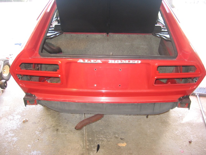

Interior out to local upholstry shop..been around since the 40's so I figure they can handle it.
Did some body work. water collected in the taillights and of course, the steel dissolved so I had to fab some sheet metal mounts and bondo and prime and 501 alfa red (in a spray can made to match for 14$)

Seating will be leather on seating surfaces and vinyl for the rest, door panels done to match...color: light camel

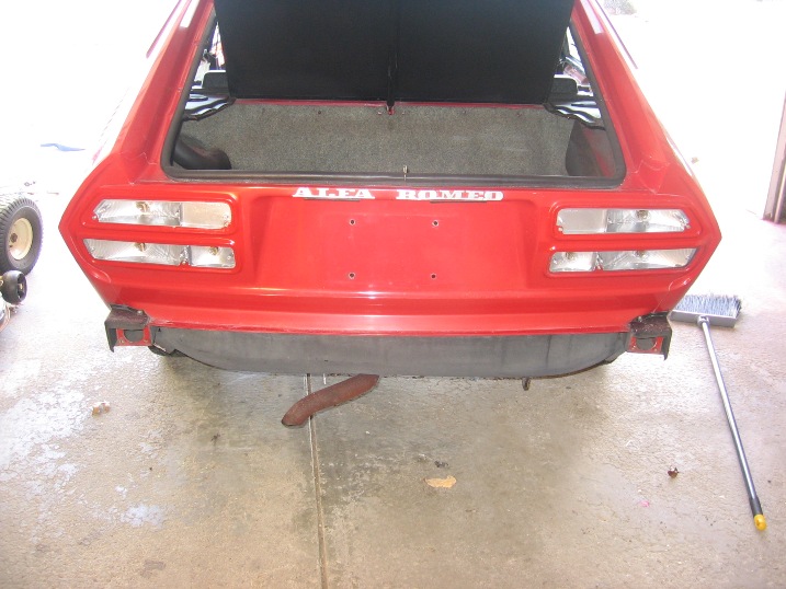

- primer, few coats of base, and 3 coats clear
- IMG_5239.JPG (112.41 KiB) Viewed 15157 times
- original reflectors, cleaned, wiring repaired, flat black base followed by Testors model chrome (3 coats)
- IMG_5242.JPG (116.29 KiB) Viewed 15157 times
- New old stock lenses direct from the old country
- IMG_5243.JPG (160.91 KiB) Viewed 15157 times
- IMG_5241.JPG (160.5 KiB) Viewed 15157 times
