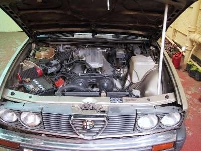

Hi guys,
I have an Alfetta GTV 2.0 which was built in 1976.
The previous owner had modified it to look like a GTV6.
This is the car:

Re: v6 conversion
Yeah its possible . You said your GTV was a 1976 model . Do you have any pics of engine bay in front of engine . Some went to lot of effort to do that conversion but I'm interested to see if they changed the lower cradle ( valance ) so the bigger radiator can drop .
Which fuel tank is in your car as you need the return line for the fuel injection . Do you have people who can modify your prop as you can keep the existing prop but cut the front section and join the 75 prop and you can be out by as much as 5-10mm as its on spline but obviously try be accurate . From the middle hanger on prop back its in a fixed position . You can also change entire prop to fit on the 2litre from 75 but then you must change yoke on clutch and sadly you have to cut and modify prop as I remember 75 prop is longer .
I did this on my 116 Alfetta .
Engine mount bracket gets extended forward . Note the engine does not sit straight in the car however if you do make it straight you will have to adjust bell housing bush as its offset . Which reminds about the bracket under car for bell housing you will have to adjust from the 2.0 to the 3.0 .
Its always easiest to know direction you going then put engine in car and measure up from there . Its not a difficult job but its a real pity you want to take apart a really nice 75 unless the body is rotten to bits .
Three of us did this job on the Alfetta in a weekend excluding getting the prop welded and balanced . ( it was a long weekend ). It was a great car which my mom used for many years in her gardening company towing trailers every day . :D
