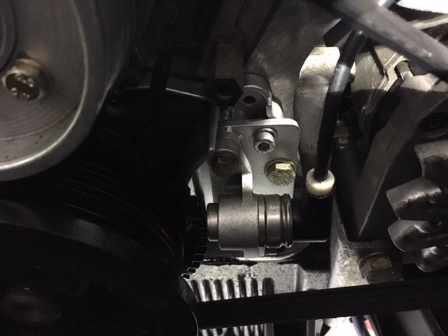

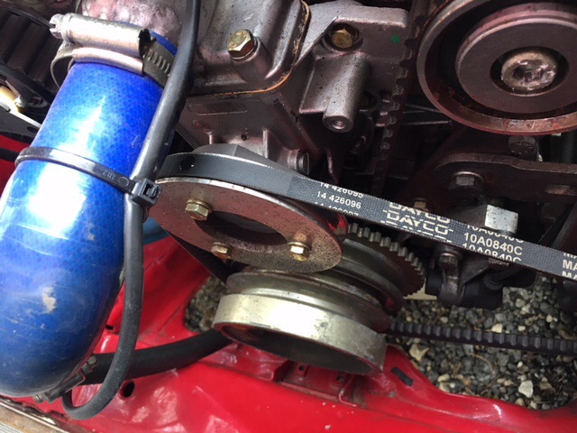

Some pics of a GTA pulley with one of my trigger wheels machined and heat pressed on . Also some ideas on your water pump .

Or 75 pulley

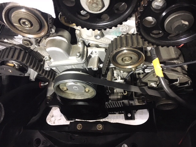

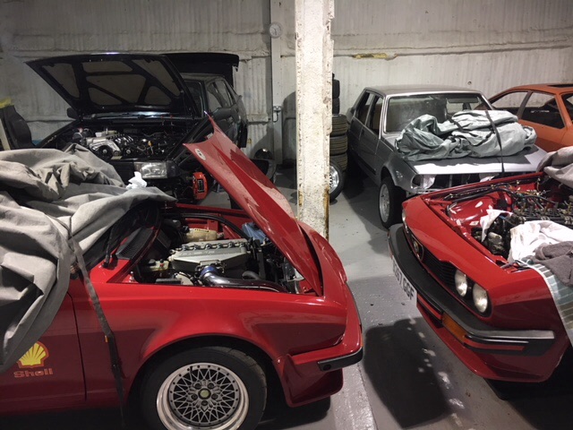

The motor with black covers is in George's 75 behind my 3.7 . It's service time on my GTV carbi car as can see ( not clearly ) cam covers off with new Cambelt . Only done 3000km but it's been five years . Thought i would take some pics today of water pump pulleys!
