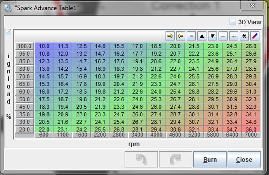

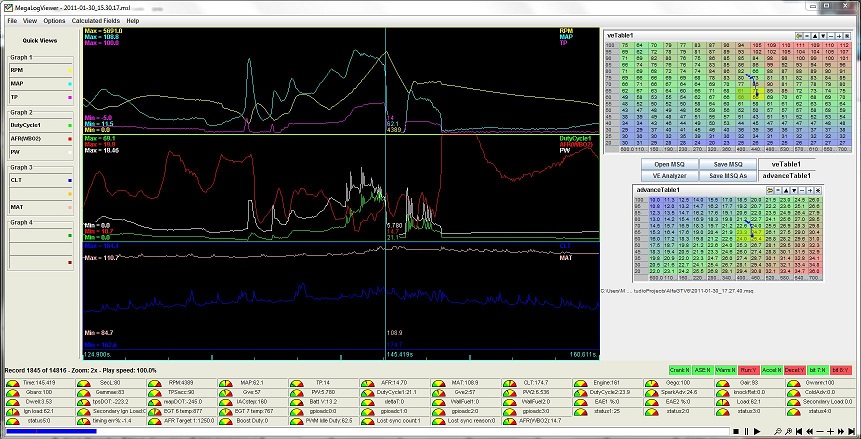

The engine started up on the first twist of the key & the TunerStudio 'Autotune' feauture called VE Analyze Live works well! I'm sure I can get the mixture correct - but I am researching the ignition advance map still:
Does this look reasonable for the engine?
Here is a screen shot from mega log viewer showing a tuning run. One can update the map offline using the feedback from this tool... or Megasquirt will update it itself using Tunerstudio. As example, at this moment the AFR is 14.7 which is too low for a max throttle run.
The current MAP showing which cells are active inthe AFR and Ignition maps are also shown.
Awesome software!

Re: 3 liter, 24 valve engine project
Ignition table looks about right as far as I can see, the only thing i'd change would be the idle advance, 22 seems waay too much for me, i'm running 8 degrees on my 33 16v (wedge combustion chamber, short stroke too) and I got best power when I went from 26 degrees advance to 21 degrees, these wedge type combustion chamber don't seem to like too much timing advance, about 36 degrees is what I have for low loads at cruising rpm's.
I got most of my ignition map done in reference to the original motronic one, if you want I have that ignition timing map from the 33 16v for reference, otherwise, very very nice!
