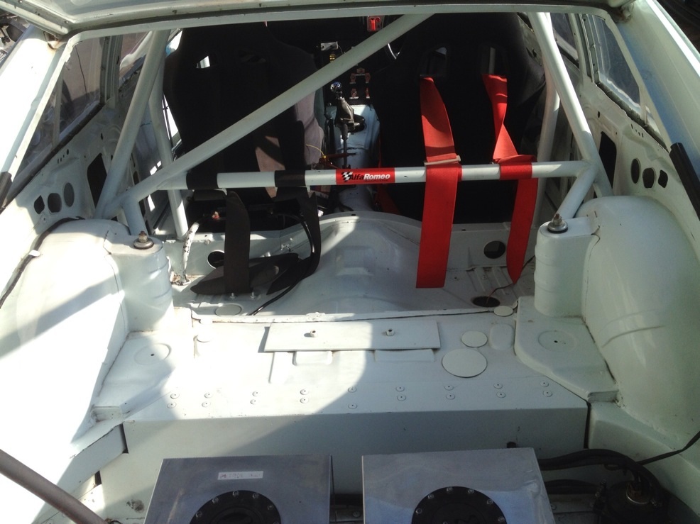

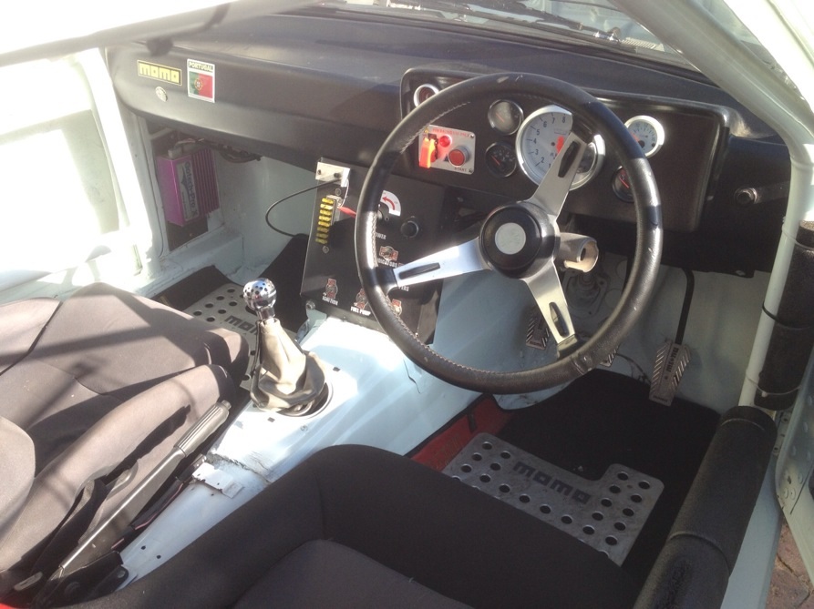

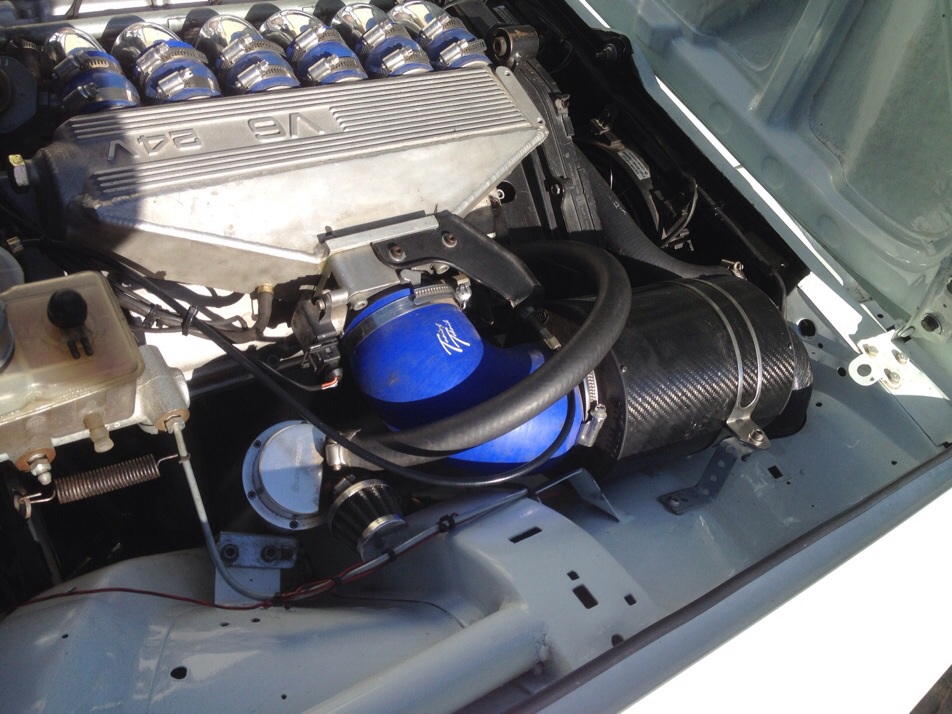

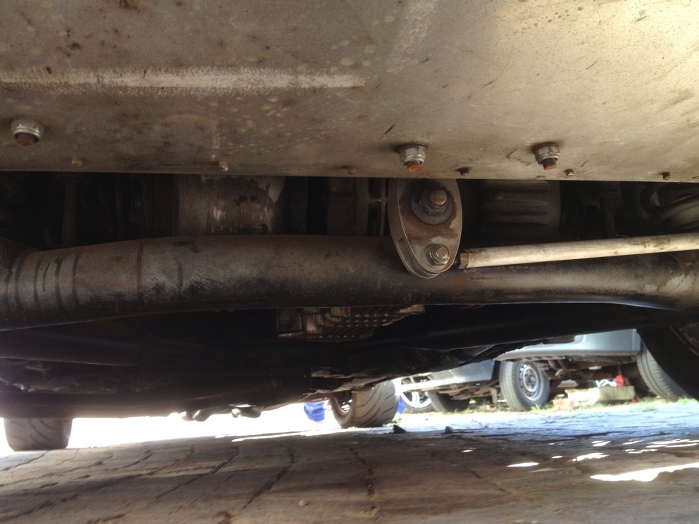

I saw Nelsons car while I was in SA at Alfia auto while I was getting my dads 24v spider thermostat changed . Giovanni and Clayton do an excellent job on keeping the Alfas on the road in SA . Thought I would snap a few pics and take short video which I will upload some time .
Nelson has also finished it off really well . Love the airbox and dash layout . Classic steering wheel :D
