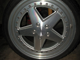

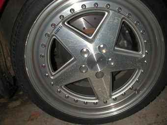

Any one Ronal Rims (Gotti R-1001 or G-1001)
I had purchased Ronal rims a year and half ago and about after six months the clear coat finish started to crack and haze. I have been emailing the co. back and forth for a year now insisting that the finish is defective. However they insist that it is not. The rims have only ever been washed with armoral car soap and then they get mothers carnuba wax. So far all they can offer me is a $175 cost to reclear coat each wheel and i have to pay shipping to and fro California. Has anyone had a bad experience with these rims or any Ronal rim? If you could pm me or post that would be fantastic.

What is Ronal saying to you, something like: "you must have driven through some type of caustic, or acidic liquid? The one picture sure looks like Aluminum oxidation under the clear coat, but it is difficult to tell.
