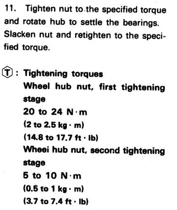

I cannot seem to find the torque specs for the front wheel bearing. Anybody know this?

here
Front bearings.jpg (21.19 KiB) Viewed 4057 times

Thanks, Micke. I couldn't seem to find this in the manual, but then I was a little burned out from working on the car.
