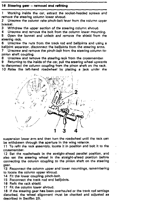

Kevin,
Being the laziest typiste in town, here's a crappy extract out of the manual. Hope you can follow it. If not ,ask more questions.
Steering Rack Removal.jpg (166.26 KiB) Viewed 7893 times

I'm in the middle of this and am having problems getting the rack out. I've got it unbolted and the steering wheel shaft off but can't see how it fits throught the drivers side opening. I've got the engine mounts unbolted and the engine jacked up about 1".
Some one give the tip that is going to get this rack out.
