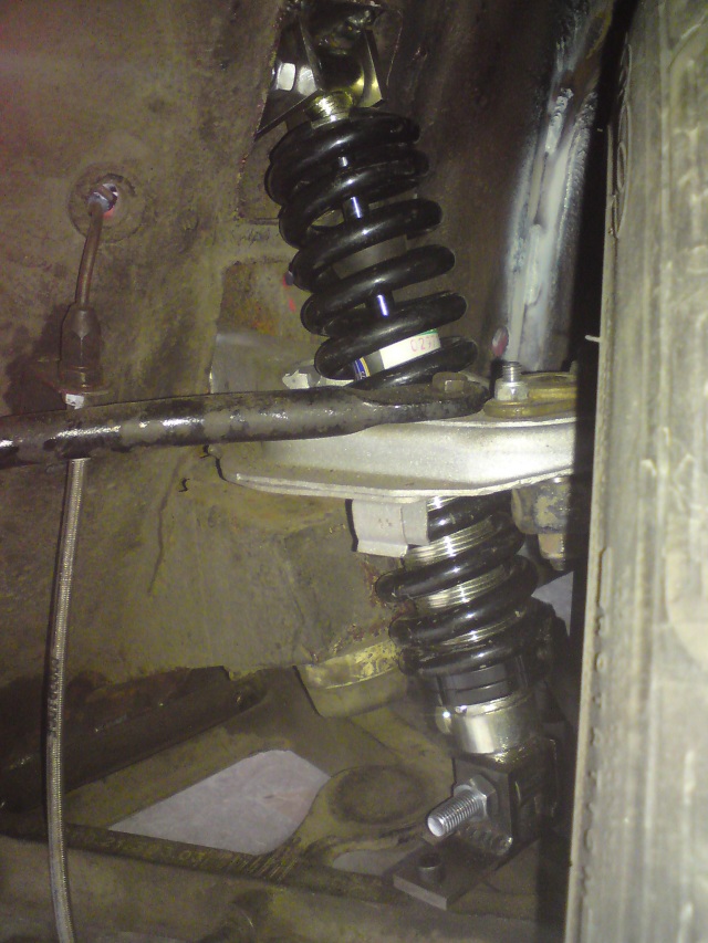

Here's the promised pic. Mind you this is still work in progress. Need to buy imperial screws for the coilover bushings, and make few minor adjustments, order new shorter coils, and helper springs. The front coilovers are from GP line (universal, matched by dimensions), whereas the rear shocks are direct fit for 75/GTV(6) (check catalogue)

So, You bought as planned 170/100/B12? Is there possibility to specify while ordering coil length and spring rate? And last, how stiff are rear dumpers?

No problem, better safe than sorry. The rear dampers are adjustable as well, so you can stiffen them as you like. When I was looking through the gaz catalogue I was baffled when I realized that I have heard no feedback about gaz shocks on any transaxle alfas. You can read (hear) stuff about koni's, bilsteins etc. but none about GAZ. I guess they re new into this little alfa market. I looked into invoices to be 100% sure if they were the 170/100/B12 but couldn't find the model name. My hint is this, substract 2-3 inches of stroke since it is approximately what the adapter brackets will take. Now With my coilovers I have around 8cms of stroke and LCA's are pointing slightly upwards.
