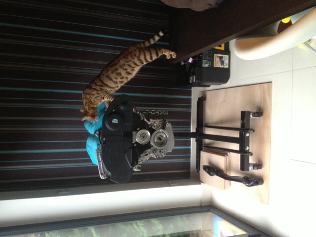

Pity you were looking for that now as I just sold my original Autodelta Adjuster set plus 28mm bars . Now my kitten has nothing to chew on
Your only option on torsion bars is from USA . Probably need 33mm solid if you want equivalent off 200kg springs ( linear ) up front . The only problem for me is those bars are splines are cut - broached and not rolled . Our lecturer always insisted on rolled as you don't get stress risers . I think its same concept of having your wheel bolts CNC cut - its no go . But then I have not seen anyone report a failure so that's a good enough trial . News would spread fast if a set ever failed .
Starting to feel miserable after parting with rare genuine Autodelta parts .
