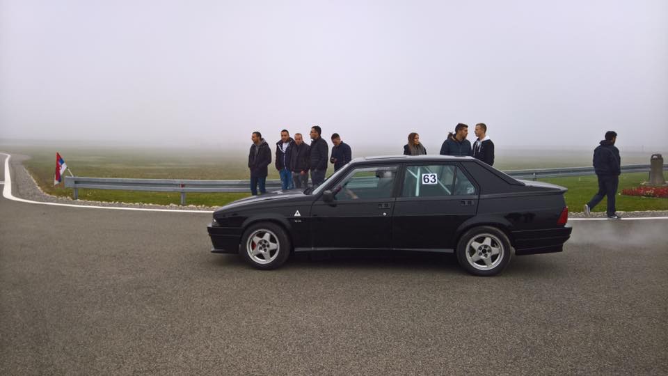

Front - Rear track width and transition while cornering..?
Hi!
Need some advice from you track wolves about this topic since I have quite nervous rear end. Do you build your cars within factory proportions (front/rear) or you're changing track width?
Current setup on my track car:
Front: Coilovers 80kg/cm springs + factory torsion bars, Camber -3, Toe out 1mm, long nose upper ball joints, factory anti roll bar, tyres toyo r888 195/50-15'
Rear: Coilovers positioned next to rear wheels 60kg/cm springs, toyo r888 215/40-15'
Front is +20mm spaced per side / Rear is +24mm spaced per side
Any thoughts about current setup?
Cheers!
Cheers!
