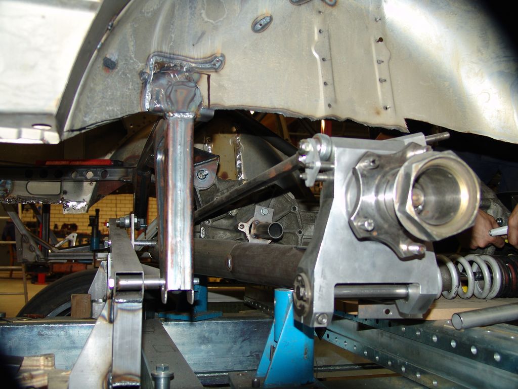

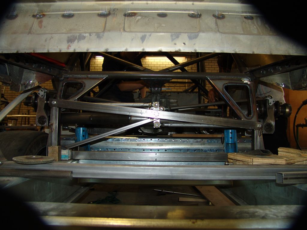

hmm what the hell is this ?
A chassis jig for making custom watts linkage mounting points. Nice adjustable camber too. :)
Maurizio
Posts: 680
Post by Maurizio »
:wink: someone with a large budget...... This thing is soo increadable fast on the track
(daydream mode) Who wants to sponser me, so I can quit my job and build something that beautifull. :wink:
