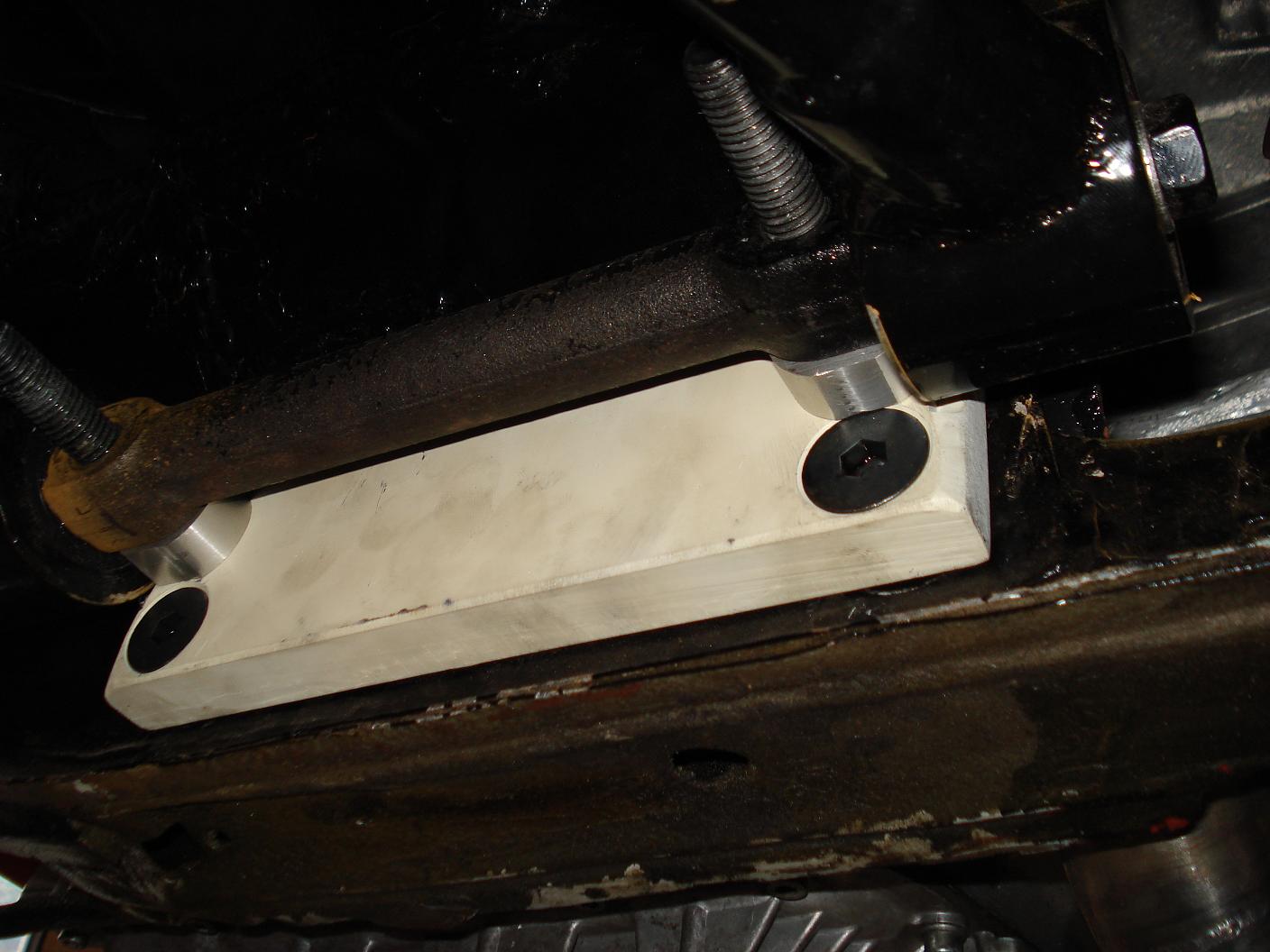

Maurizio: Why would you not trust aluminium? Your wheels are aluminium, so are many suspension details for newer cars as lower/upper a-arms :)
If i am thinking right here i asume the biggest load at the aluminiumbar will be at the outer wheel when cornering, then the forces will push the aluminium against the orginal steel frame construction? can anyone estimate the load at the lower a-arm?

Thanks Micke and Barry. I am just a dumb viking trying to make a nice handeling 116 chassis :).
Just throw the alu out the window? Mats?
Jarle,No!..I would simply fit a back up plate on the inside of the leg and extend the bolts to go through the chassis leg.No need to throw it away..Its a good idea.
The leg will be hollow but you now have two rather solid ally plates on either side AND bolted into the original locations as well..That would ,imo,give me peace of mind. :D :D

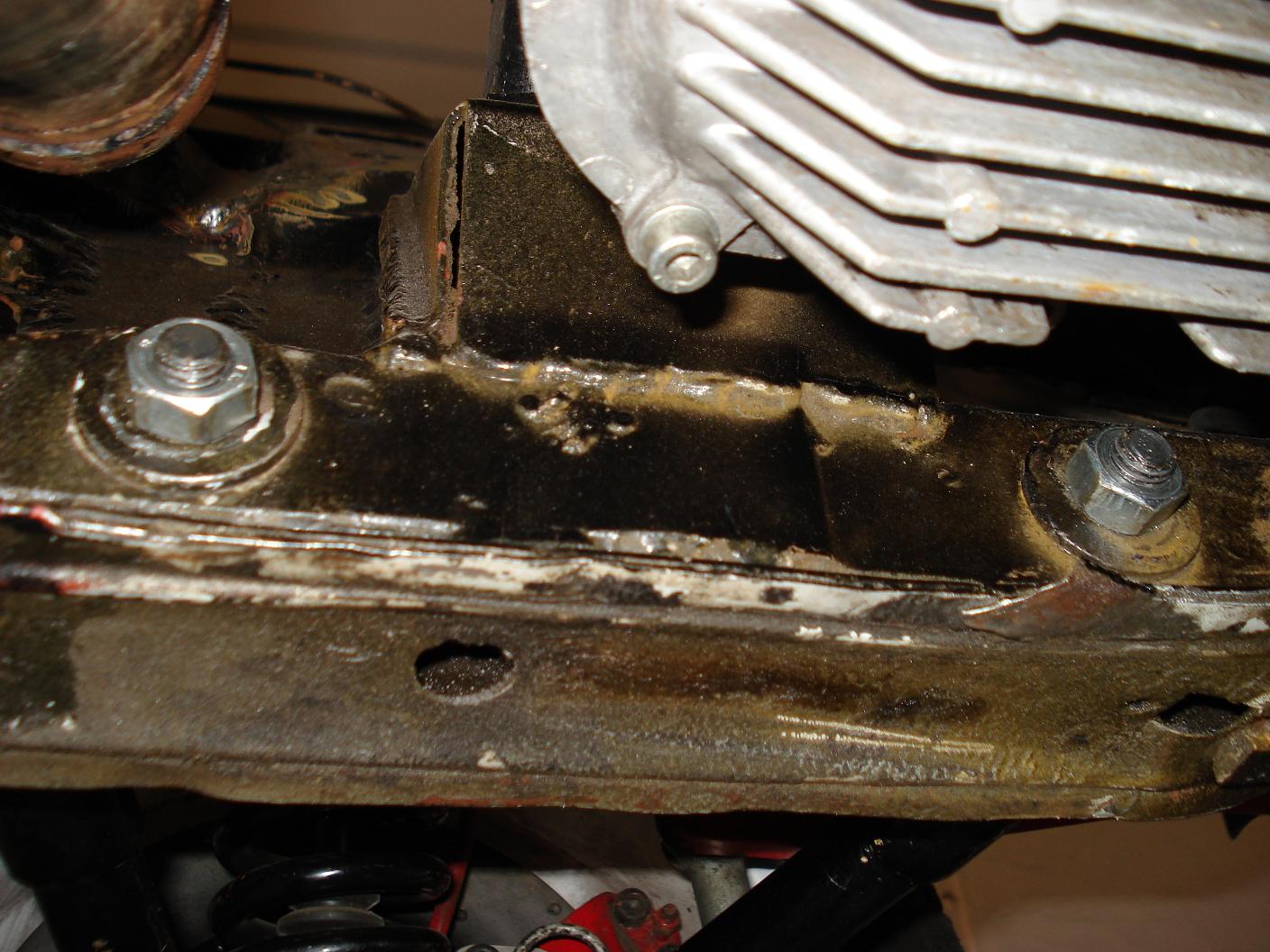

Barry: As the setup is now the bolts go through the leg and are attatched by nuts on the inside. Your suggestion is to also add a backup plate on the the inside with the nuts to strenghten the leg?
p001 001.jpg (133.49 KiB) Viewed 9571 times
p001 002.jpg (210.38 KiB) Viewed 9571 times
J,The inside plate could encompass all 4 the bolts.The idea for me would be to have the top bolts go right through the chassis leg and tie up with the backing plate.
Looking at your pics the setup is pretty strong.I would still be wary of fatigue as its setup now.
Come to think of it,the inside does not have to specifically have a plate as such,you could simply use large machine washers under the bolt heads..
Recap-four bolts,bottom 2 as they are now..Top ones going through the LCA imo,should also go through the chassis leg .
You follow what I'm rambling on about? :wink:

Got ya! Nice idea, i will get som longer top bolts to get all 4 bolts through the leg! Thanks
Shoot some pics when you done..Id realy like to see what you did..
Already thinking of doing my Giulietta..Thanks. 8)

@Jarle, this is the problem. I'm not that afraid of using alloy or stainless steel. Just use them within their limits 8)
Get the cantilever effect out and your probably in the safe zone.
The suggestion of the backing plate is a good one! But still there is the problem of the thin sheet metal. I would like a metal tube inserted around the bolts you added which go toward your backing plate. Weld the metal tube in the original sheet metal. The tube will connect the inner and outer sheet, which give more stiffness. Under your alloy plate use rivets towards the chassis, that will make defined lay on point to introduce the forces!
