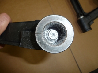

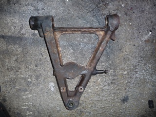

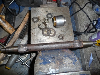

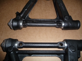

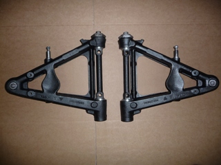

Re: Front lower controll arm bearing.
Hi Guys !
During the weekend I had a bit of time and so I removed a set of lower arms out of an old 75 3,0 V6 and then I "Played" a little with aluminium and mashined spacers and sleeves for the new construction with ball bearings. I also have made the sleeves on the torsion bar side with an end stop for the bearings. So there is now no possibility that the whole axle with bearings move inside the sleeves in axial direction. On the other side I mashined the big end caps so that the it will fix sleeve and outside diameter of the bearing.
I´ve made some pictures where you can see, ... take OLD make NEW.
Many greetings from Austria
Wolfgang
Nice work
Maybe you should produce some and sell them - I am sure you will have a few takers
