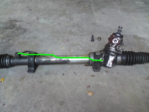

Thanks Scott. So I basically I need to connect these two, seal the rest and voila?
- Kopia maglownica 75 TS 1.JPG (43.03 KiB) Viewed 5179 times

Hi PietereQ:
I do remember getting your email, I thought I answered it, but perhaps not. I was highly medicated for a couple days last week. I am fine now.
To answer your question, the way you have shown it with the green line is correct. There should be another hose on the other side to equalize air pressure from the rubber bellows. That's it, just two hoses.

Yeah unless you pull the rack apart to take the seal out, in which case you only need the tube between the bellows

Don't foget to fill it with fluid or connect the reservoit tank to it for lubrication(pump not necessary).
..then sit back and watch it piss out of the steering rod seals over the garage floor just to make life a little more fun. Another words,if it is an old unit, do the seals up first before you install it.

All fluid should be removed and the rack should be packed with grease. Even if the seals are poor, it won't leak, the grease is too thick.

Thanks for inpt guys, I have drained all steering fluid, packed the rack with grease, and put the balance lines. Now the rack is installed in gtv6 and connected to the steering column. And there's slack. the joints on the column are 100% tight, so the slack appears to be on the rack, i don't know is it normal on a converted ps rack, or it just needs reconditioning? (yes steering wheel is awful but it's just proxy stuff)
