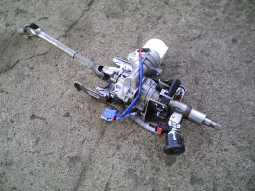

a time ago I came across the picture of a power steering equipped renault twingo.
That is a unknown vehicle in the us and aus I guess.
And yes it is a flimsy shopping car, but look at the picture... electrical power assisted integrated in the column.
Re: Power steering on 24v, rwd
The Opel Corsa C has the same kind of system. :wink:
There a quite a few conversions done with these systems already and most are very pleased with it. :)
