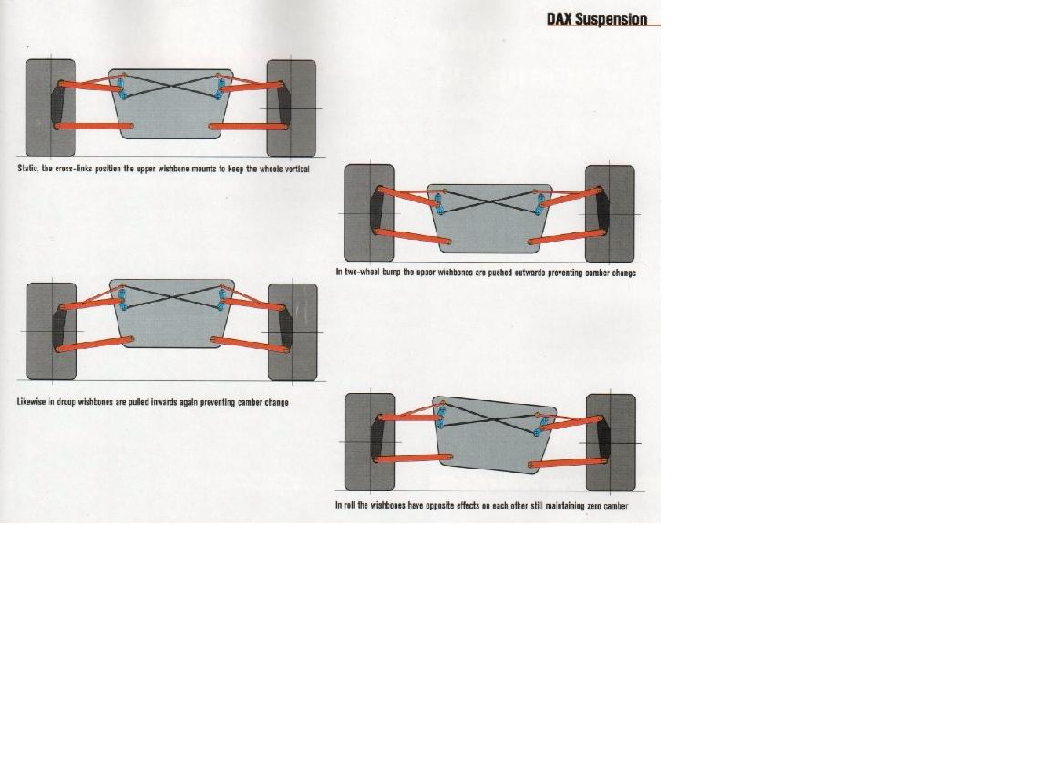

Ok, Check this one out, then....

camber compensating IRS ... verry interesting no much camber change during drop or bump exept static , ideal for rear end :D

TS_turbo wrote:camber compensating IRS ... verry interesting no much camber change during drop or bump exept static , ideal for rear end :D
I'm not 100% convinced on the dax system... I'd be interested to see the roll centre migrations etc. Besides, you do want some camber gain in roll during cornering to compensate for tire carcass roll.
