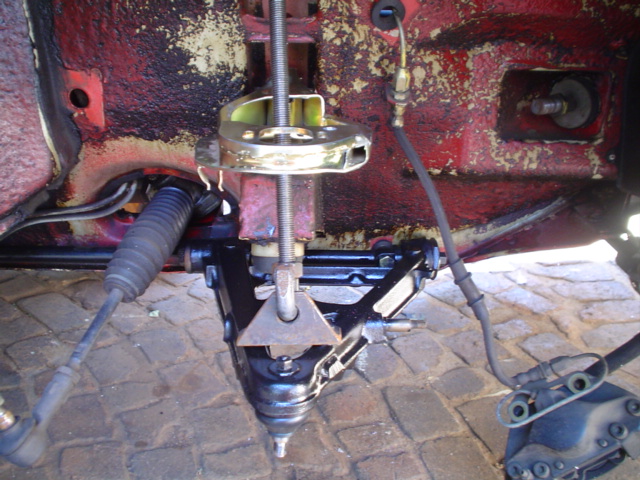

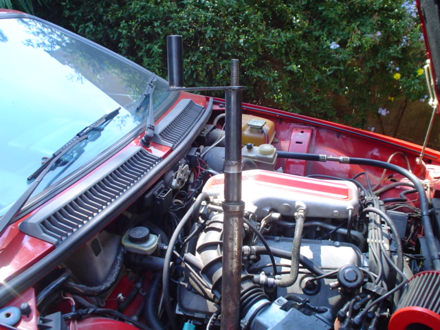

Make up a simple tool for the torsions.
- DSC01903.JPG (152.68 KiB) Viewed 9812 times
That's BarryTube. When you make it, it will be called GrantTube. But in general it is called a YouTube.
The threaded shaft goes through the shock tower and threads into the LCA's mounts. The threaded shaft also goes through the big tube in the engine bay. The big tube must have some kind of a nut in there. You turn the crank at the top of the big tube, which in turns brings the LCA up or down. So you can easily adjust the height of the LCA before you try to push the torsion bar back in.
Barry am I right on this?
Sadly I think this method doesn't work for bars bigger than 25.4. Because with bigger bars, the LCA has to come off as the bigger bars cannot slide out the back of the cross member.

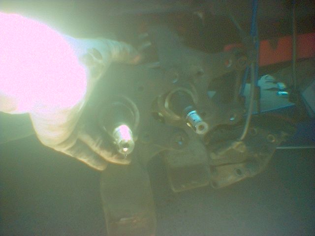

Before I had drop spindles, my car would lose camber when cornering hard...so -1 degree negative would turn into like positive X degrees camber...reducing front grip.
Now with the drop spindle, it's a little bit better, but I think I need more static camber regardless. The drop spindles set the LCA lower for the same ride height as before changing the spindles. That would raise the roll center...what effect this has on my 28mm front sway bar, I'm not sure, the car seems roll about the same. It does seem quicker in transitions actually. The drop spindles also reduced my bump steer quite a bit. I wasn't sure what bump steer was before, but I think I've got it now.
Supposedly the drop spindles would raise my UCA, which should further effect my camber gain in a good way, but that's not the case. On my drop spindles, with the car sitting at the same ride height, my UCA's are the same as before. Only the location of the lower ball joint gets moved. A well known alfa racer in California, Larry Jr, mounted his ball joint below the UCA with nuts and bolts, I think. This made the UCA more angled.
I'm going to set the camber to about -2.5 and see how it goes. If that doesn't kill th eundersteer, I'm not sure what else to do short of getting custom springs for the rear.

- See how the ball joint would be located lower?
- image_00042.jpg (30.81 KiB) Viewed 9785 times

That doesn't make any sense at all, the joint is in the exact same position and that is all that matters. The arm itself can look like a banana (like on the IMSA cars) or whatever, as long as the joint doesn't move it's function will be geometrically identical.grant wrote: A well known alfa racer in California, Larry Jr, mounted his ball joint below the UCA with nuts and bolts, I think. This made the UCA more angled.

I'm not sure if I agree with you about the ball joint thing. Somehow it seems that if the UCA is at a greater angle than stock, for the same wheel movement in compression, the top will want to tuck in more.
Maybe I need to think about it more?
