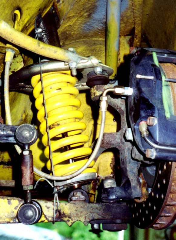

Here. For reference the brake disk is 298 mm.
Front suspension.jpg (62.26 KiB) Viewed 12652 times

I still dont understand what that pic is showing. Can someone explain is easy to understand terms pls :oops:

Is that a custom upper control arm? Is it to aide in fitment of the coilover? It looks to me like the lower balljoint is upside down, while the upper one is in normal position. Correct?
I was thinking of flipping both upper and lower ball joints to maintain the same geometry, but if this geometry is better...
Very interesting stuff.

Yep. Custom.
It's lighter, bigger hole for the shock, uniball inner end and length adjustable.
Keeping the "normal" upper ball joint adds camber gain and has the same effect as the famous knuckle raisers in the 105 cars.
The steering arm is bent to reduce bump steer.

Do you know what size heim/uniball you have on the inside of that arm? I think I am going to have such a piece made.

Sorry. It's 10 years ago and I can't remember. The same size as the bolt anyway.

For track, the upside down way. Call me strange but I don't like the knuckle raisers much. Adds camber gain but doesn't help roll center. Actualy even makes it slightly worse.
