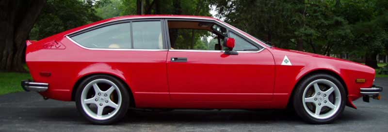

The suspension is AR Ricambi's sport suspension front and rear with yellow Koni dampers.
Thanks, I am glad you like it!
-Brian

Got around to taking a few measurements:
Front 580mm (22.8" or 22" 4/5 for you carpenters... ;) )
Rear 530mm (20.85")
Haven't had any problems with the sump, gearbox seems to be taking a few beatings from the curbs though...
