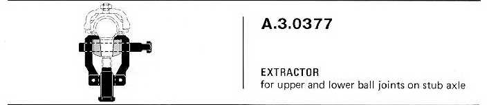

Mark if Barry's method doesn't work for you, try and get your hands on the AR tool.I borrowed one from my local parts guy and it makes the job very easy.

And the answer for me was to get a pickle fork with the biggest hammer in my garage and wham, bam, thank you mam, .....it popped apart. I generally hate to use the brute force method, but the situation seems to require it. If you wanted to save the ball joint, then the Alfa tool would be necessary as the pickle fork rips the rubber boots.
