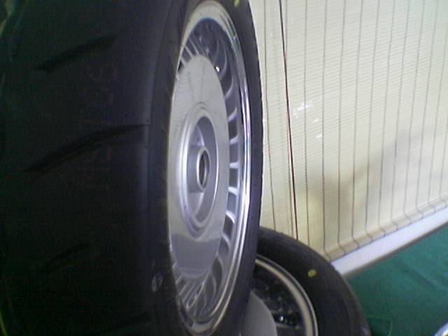

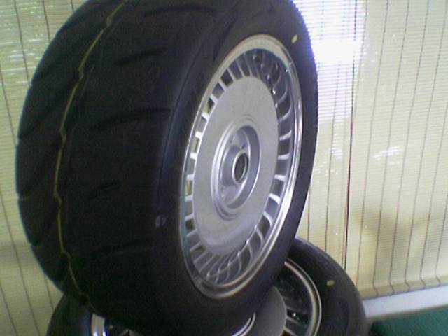

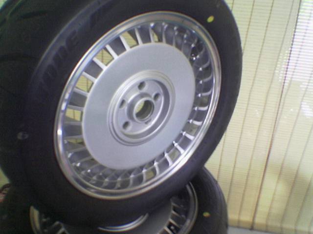

Widened std. gtv6 wheels..~nice one Kev..-Barry
Paid ol` Kev a visit today and he showed me his new wheels..Bloody nice..
Widened std. gtv6 wheels.. :wink: 8) 8)

how did he do that?!
:D Its an old racing trick ..
You need 8 rims or at least 4 others that can be cut up to make the outer lips.
Machine the originals off and machine up the new outers from the donors..
Very important to have receiver type grooves for the 2 parts and then weld..
After welding,clean up and final machine-have them x-rayed and if they pass,paint and polish!
Kev used 4x 164 15 " wheels as donors.. :wink:
