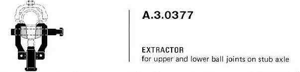

Mark unfortunately no you're not missing anything.You've done everything you can do with the tools you have.I recently went through the same process exactly.Finally I went to my local Alfa guy and borrowed the Alfa ball joint tool.It projects the forces in exactly the correct way and bang out it comes.A standard puller just can't seem to drive these suckers out.Carefull with the banging.These "A" arms are cast and can crack.Hopefully you can borrow a tool from a local shop or Alfa club member.Good luck.

Murray,
Is that extractor for the tapered shaft? It's the top part I think Mark has the problem with

David you caught me on this one ! You're correct the tool is intended to remove the lower tapered shaft.What I did -and forgot about until now-was I removed the horizontal piece which serves to clamp the jaws together (It gets in the way when you're undoing the balljoint from above).I then substituted this with a C-Clamp which I was able to locate correctly.The strength of the little Alfa tool was still more effective than the other methods I tried,but if you can get the screwdriver method to work it sounds like a simple solution.
