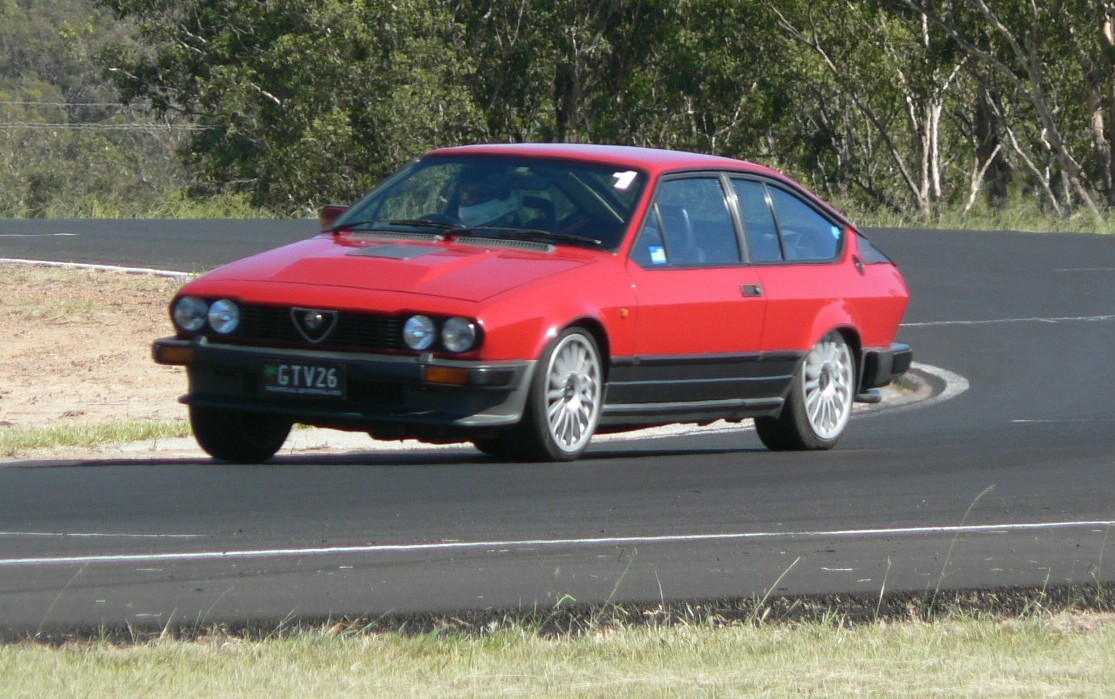

don't have any close ups of the wheels, but this pic at Morgan Park at Warwick shows how they sit in the guards pretty well

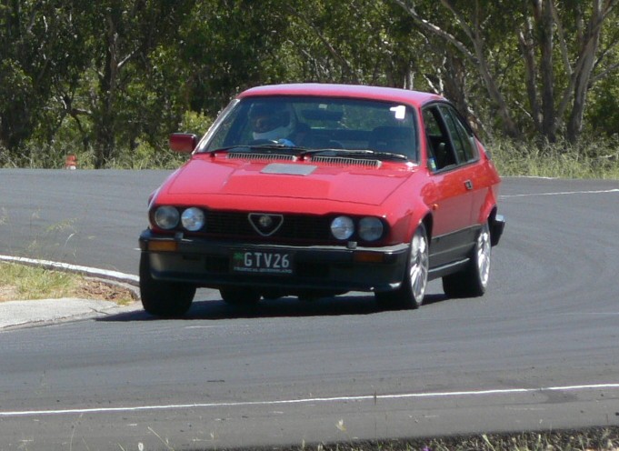

found another, probably better for showing clearance
