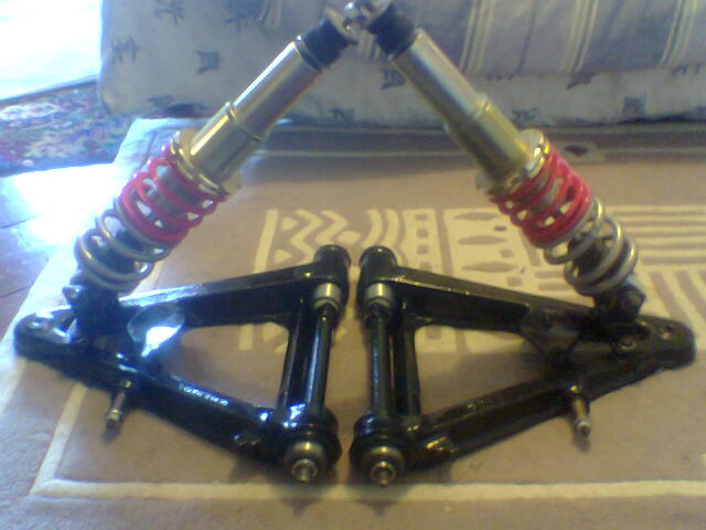

MD, you could also look at the Ron Simmons suspention set up, handles like its on rails.
PB uk

Hey PB: that's such a pretty picture!!
...did you have to trim the upper arm at all for the spring?

Hi x-rad,
No I didnt have to trim the upper arm for the spring, although it is a tight fit but dosnt catch!
PB

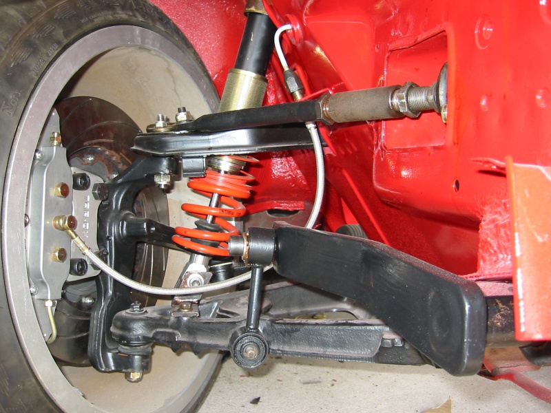

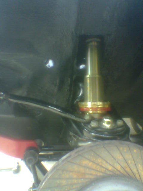

Heres another.
PB n J: that is a tight fit..no touching even on the tight corners?..
I am seriously considering the front coil over setup...don't have the money for the ass end right now

Hi x-rad,
You gotta do it the handling is great, I spent over £1000 on RS kit, well worth it and looks great too!
