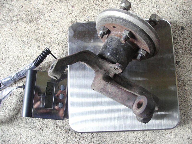

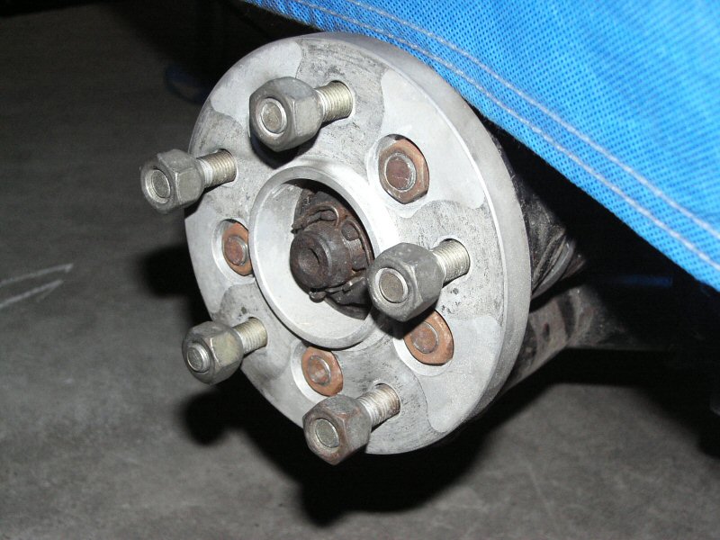

Fronts are countersunk - bolted to the hub & brake rotor and the whole assembly then put onto the stub axle. Rears are counterbored and the nuts sit flush with the face.grant wrote:Daniel, how did you get a counter-sunk bolt on there? The only adapters I've seen require wheels with "pockets", which seems to only apply to some after market wheels?

Counter bore is ... mmmm
Think of the hole that the stud protrudes through. Now bore a larger hole, big enough diameter for the nut (and the socket to do it up) and deep enough that the nut sits fully inside it.....
Ah, too hard to explain, I'll go take a picture.
Fronts are countersunk bolts from the outside with nuts inside the rotors - no original wheel studs.

- Fronts, obviously without the brake rotor
- 08-01-05 008.jpg (138.18 KiB) Viewed 10900 times
- Counterbored rears with shortened original studs
- 08-02-13 002.jpg (101.41 KiB) Viewed 10901 times
