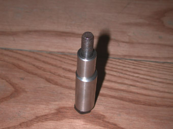

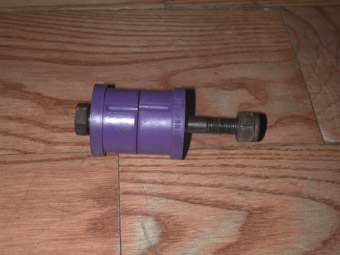

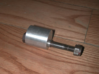

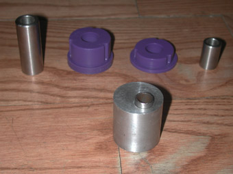

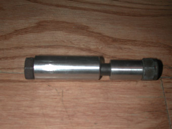

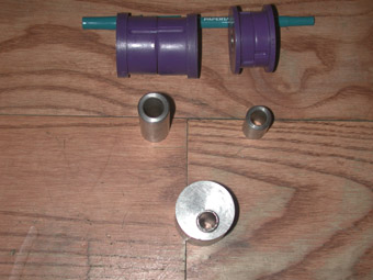

when i ordered from alfabill i was first sent the incorrect part number (pff1-201) which is for the inner control arm on the 115 series cars and this is the small stubby bushing on the right side of the pics. the 116 bushing is on the left. the metal bushing on the bottom is a "steer rite unit from alfaheaven.com. the sleeves are placed next to the corresponding bushing. the id of the metal sleeve for the 115 is 10mm the od is 16mm. the id of the metal sleeve for the 116 is 12mm and the od is 19mm. the inner and outer diameters of the both the 115 (201) and 116 (301) bushings are the same (15mm/35mm). the steer rite has a 35mm od and 10mm id.
i think the sleeve is the wrong size... there is no way to get that in there.

here are the pics. that is the factory bolt in pic's 3,4,5,6

more pics...
