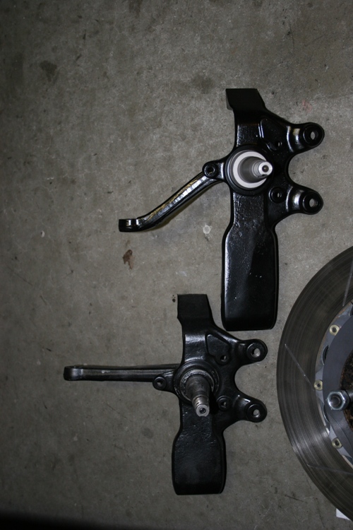

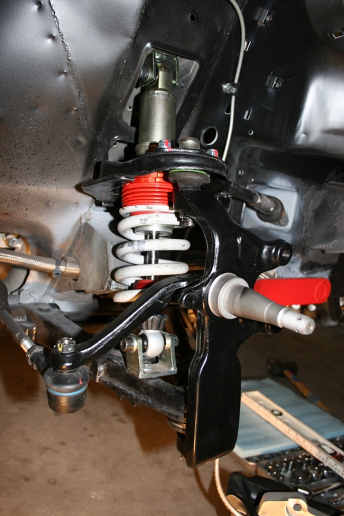

I finally got time to re-do the front suspension on the 3.7 race car. It now has 1.65" drop spindles from Richard Jemison, and Ron's full race suspension which eliminates rubber/poly bushings, has adjustable shocks, and uses a true coil over at the rear. Anyway, here are some pics.

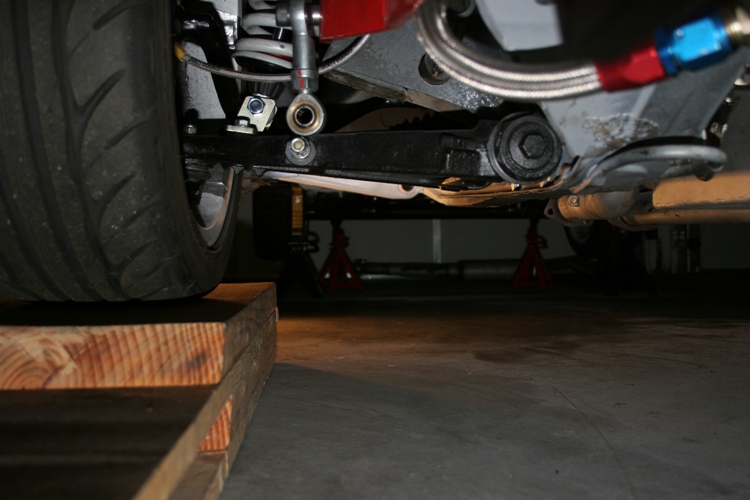

The 3rd picture shows the sway bar still disconnected where it was adjusted with the original spindle (other side of sway is still attached to A-arm with original spindle). So, it basically shows how much more level the A-arm is with the drop spindle.
old and new spindle

front right side assembled
right side on the ground (with drop spindle)
left side on the ground (with original spindle) - both sides at similar ride height
