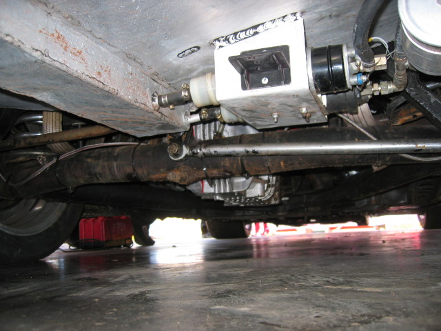

OK I see an alt watts mount on the bottom of the dedion, outboard brakes, a strange diff, limiting straps, big fuel pumps ... have I missed anything?
Clearly is just some hack from running down to the shops (NOT!)
OK spindles brings up the roll centre, so less gap to the c of g and therefore less 'leverage' (to use an inappropriate term) creating less roll, thereby taking more load on the front tyres, less load on the rear tyres and moving the balance towards more understeer and less oversteer. The drop on the watts should do the same thing at the other end of the car - Both of which are pretty much the reverse of what my car needs (and any other 116 that I've ever driven) :?
ergo I just don't get it.

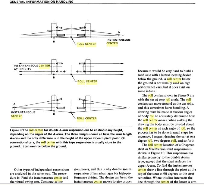

Fair enough.
Is this the kind of diagram you're after?
Incidently, my car looks more like the top set up with the KR 'cause it's not as low as it use to be (LCAs nearly horizontal)
