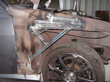

Pic of my inner guard bracing.

faaark me, never seen that before. Is that...meccanno? :P
If you are going to feed a lot of load into the top shock mount, I'd be trying to tie it back to something - maybe the firewall with support from a cross brace behind it (in the cabin) - as well as stitching up around the rad upper and lower (as that's all there is keeping the inner guards apart).

GTV27 wrote:faaark me, never seen that before. Is that...meccanno? :P
Nah, it's commonly referred to as "square steel tubing" and has been "drilled" to aid in "lightness". Or as the technically more sophisticated might say "reduce weight". :wink: :wink: :wink: .
I've seen this sort of bracing done on an Australian built/modified Skyline GTR that was intended to be used as a tarmac rally car (Targa Tas). Even tho it had a welded in cage that went into the engine bay, they still added similar bracing. It's also become quite popular for the Japanese fraternity like the MX5s and Silvias. I know that doesn't mean it'll work, but it does look like it will to me. Unfortunately I don't have any real means of testing its effectiveness.
GTV27 wrote:If you are going to feed a lot of load into the top shock mount, I'd be trying to tie it back to something - maybe the firewall with support from a cross brace behind it (in the cabin) - as well as stitching up around the rad upper and lower (as that's all there is keeping the inner guards apart).
There wont be a lot of load, max 200lb/in springs. Unless I decide to go stand alone coil overs so maybe 350lb/in springs.
The idea is to get the strong areas of the chassis to take some extra load. If the SZs can have coil overs with only bonding (glue) to help hold the chassis together and no exstra structural bracing, then I'm sure I can safely use additional coil overs and stiffen the chassis with come exstra steel and some strategic welding.

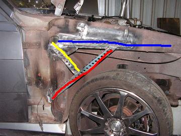

Ok some comments on your bracing.
First the lightening is not so good idea on the top&bottom sections of the tube.
The shocks (&coil-over springs) introduce a vertical load.
This is translated in a bending force in the blue line and the material which has to work against them are the top and bottom of the square tube.
The side you could lighten as they only function as spacer between the bottom and top of the tube.
What makes stiffness is the distance between the top and bottom wall of the tube. So more distance more stiffness. The blue line is an Alfa Romeo tube to get the stiffness in the shock towers.
If you had placed you tubing underneath the the ar tube (bleu line) it would work more effectively.
(Larger distance between bottom and top material)
The yellow line is unnecessary material.
If I push vertically against blue, red will become pull tube on. No way it ever wants to bend, so my opinion ... yellow is obsolete.
An X-brace above the engine is ok, it will help minimizing the banana shaping of you car during cornering, but how about the bottom... at the lower a-arm where the forces are introduces during cornering?

Maurizio, I did wonder about the bennefit of the small (yellow) piece, but figures that it doesn't weigh much so it won't hurt.
The lightening was done after seing that holes drilled like that don't compromise bending strength by much. The tube is 30mm square, 2mm thick and the holes are 13mm spaced 20mm appart.
A brace undeneath has been considered, but it would have to be made from some pretty small stuff. Maybe 15mm square tube would suffice, even tho the car isn't as low as it use to be.
As for it's worth on a road car. Well there is no such thing as a chassis that is to ridgid, even for a road car. The engine is coming out anyway, so I see it as an opportunity to put some effort in where AR didn't.

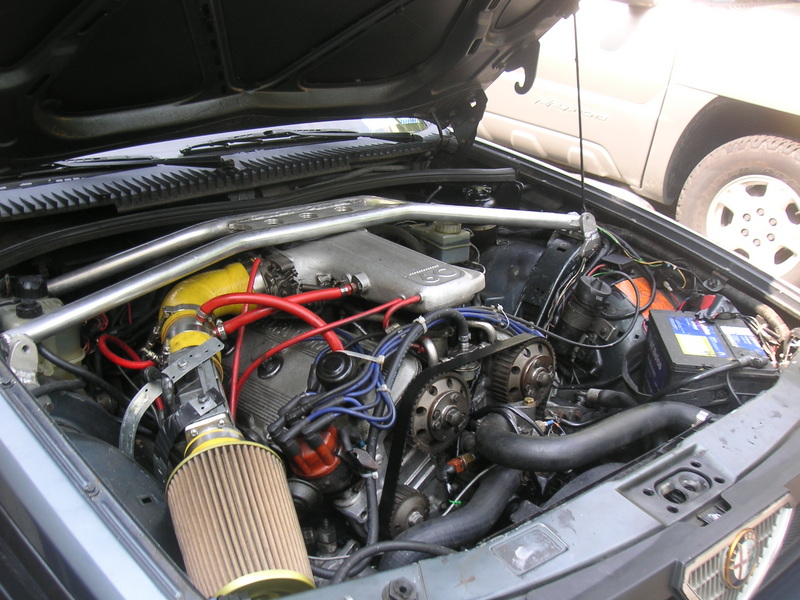

Re: Chassis Bracing and Seam Welding
here some bracing of the lower parts...
