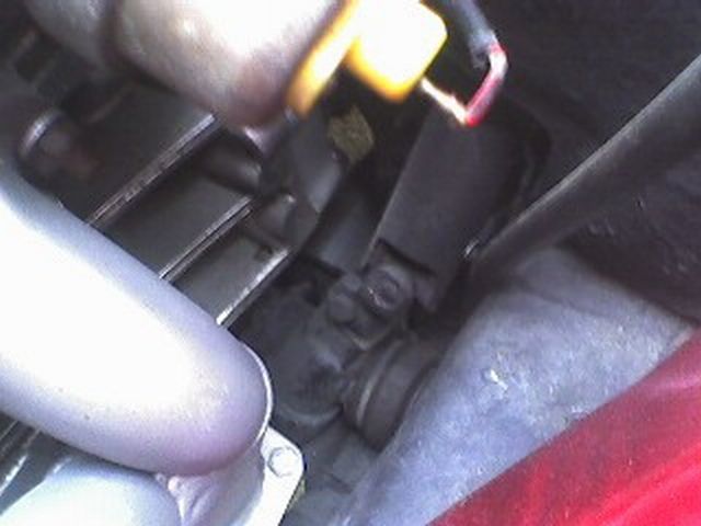

Ok, I have looked at my Alfa and I think that I found the area in question.
1).Is this the Correct part to the right of the headers?
2). Can this be repaired without taking the engine out?
Sorry for the poor picture. This is my Treo Camera.
Thanks for the info.

Re: Steering Alignment
Yes, sometimes the horn wire breaks because it rotates to much. You dont have to take engine out. take another pic on the top of that sleeve. Get some one to turn steering left and right while some one holds the front wheels. You can see the movement. If its not there then the bolt that holds the splines inside the car under the pedals has come out.
