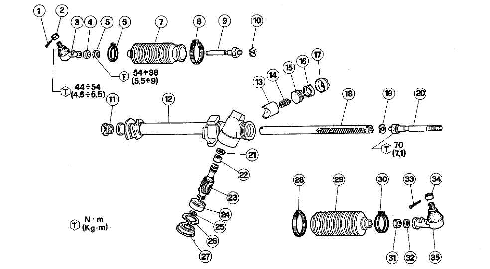

Re: Tie Rod Adjustment?
Mel in the attached diagram part #'s 9 & 20 are the inner tie-rods.Yes they are inside the boots.
- RACKPARTS.jpg (48.62 KiB) Viewed 4512 times
Murray:
That's just beautiful! After I posted the last I recalled I had bookmarked an Alfa 75 site called Craig's Place. Went to it and found some steering diagrams, but nothing like this. As we say down here in Dixie: 'preciate it!
