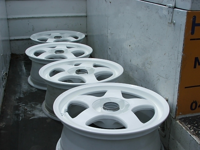

They are front 17×8.0JJ +5 / Rear 17×9.0JJ +18 114.3 PCD so they will sit out a fair way- plus I will either need to change the bolt pattern completely (not a bad thing) or have adaptors made up like Daniel did for his 24v, and Ben for his 164- which will push them out even further.... am I being stupid with these? These are the Work mesh 17s.

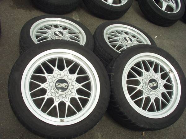

Then there are these BBS 5x114.3 * Front 8J offset +45 * Rear 9J offset +40

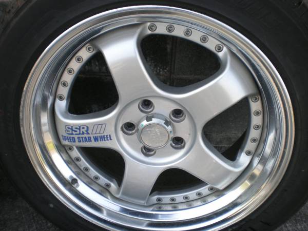

Or these SSR Professors 5H 10,0 17X8.0 +37

The first will be tight. I know they fit mine but then it's somewhat modified. No room for adaptors of course.
The rest will fit and with the adaptor thickness you can tune them just where you want them.

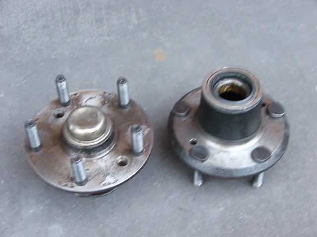

114.3 won't be possible to fit on the hubs without adding material somehow.

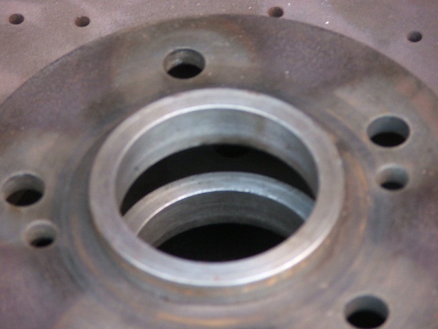

Sorry to contradict you Mats but it is possible to converts to 114.3 without adding conversion plates. We did it to the Brick to keep the original track configuration. Lots of stuffing around and requires the replacement of the rear wheel bearings as they get destroyed in the process ! Jules I don't suggest this route.
However I do recommend that 114.3 bore size as it is a common fitting of wheels in Oz so your choices get considerably more easy. I am about to do the same conversion on another racer I am building.

Strange, my 5/120 brake discs have half the holes outside the hub outer diameter, that would suggest that the 114.5 PCD would be juuuust on the edge. Do you have pics?
Re: Offset Question
Sorry mats I don't have a photo and I have since sold the car/ What I can tell you is if you examine a Nissan Skyline wheel, it will clearly show you the position it would sit on the converted hub if that helps.
Re: Offset Question
To he hones I haven't got a clue what you mean.MD wrote:Sorry mats I don't have a photo and I have since sold the car/ What I can tell you is if you examine a Nissan Skyline wheel, it will clearly show you the position it would sit on the converted hub if that helps.
The outside diameter of the front hub is about 125mm, PCD of 114.5mm and a stud diameter of 12mm makes it impossible for it to work in theory. Unless you make a spacer of some sort.

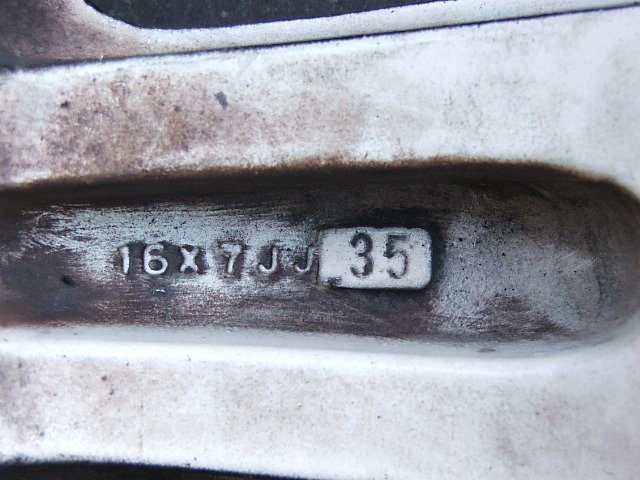

Mats, you got lucky. I found the pics.
Now seeing is believing..

Indeed it is. Now I have to measure my hubs, either my measurements are off by a mile or something is just wrong.MD wrote:Mats, you got lucky. I found the pics.
Now seeing is believing...

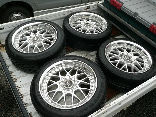

I just picked these up Jules - Stilauto, 17x7.5, ET30, 5x100PCD - Ebay, $355.
