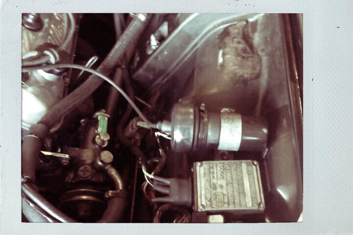

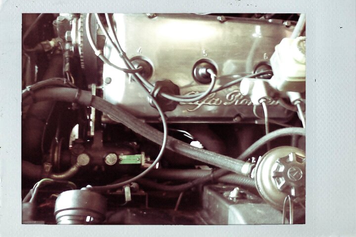

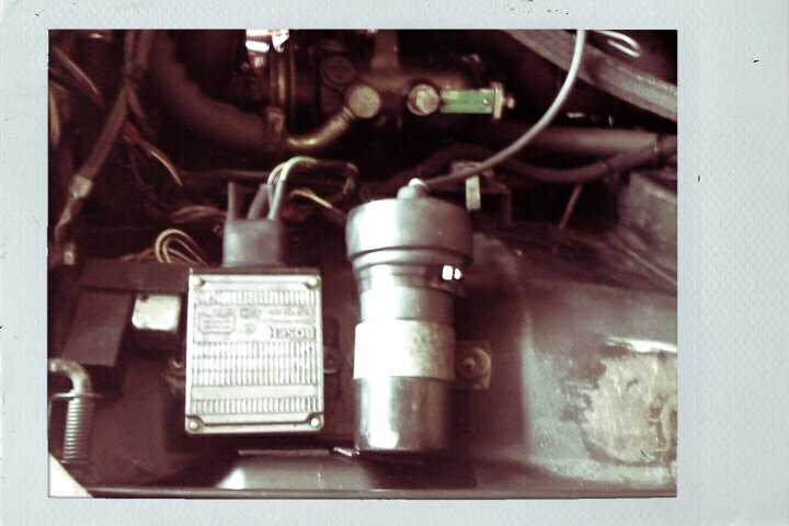

fitted pump, started fitted pipework and re locating various components like the coil, ingition module and relays too. Original washer bottle is far too bloody big anyway, so thats going in the bin for a smaller one. Just the steering rack to fit, the TS steering column and brackets to make for the resevoir.

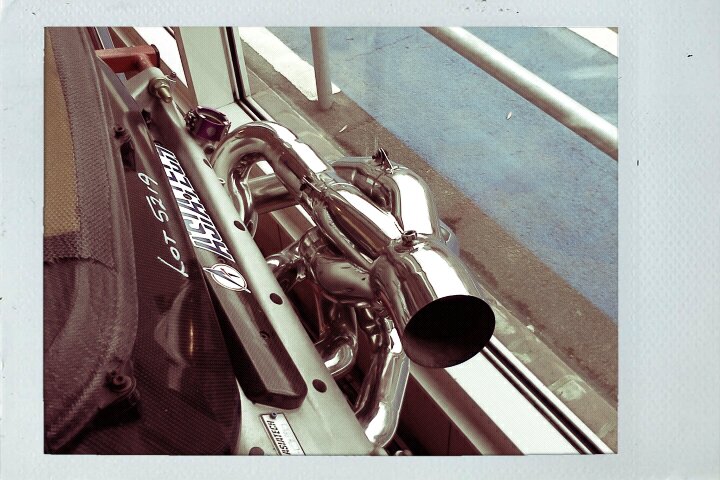

a few pics of work in progress. **uck knows why they came out black and white on my camera fone. second pic is the extractors Im robbing from my local F1 simulator company to fit!! :lol: :lol:
plenty of room for an aftermarket washer bottle/bag
i dont care what you say, they will fit!! lol
coil and module relocated
pump mounted in place

Nicee, lot's of chrome there On the header! That's some guaranteed horsepower! :D

CHROME! just for xrad.. CHROME! you wait till those CHROME xtractors go on too, guaranteed 400hp from the little 2.5! :lol:
