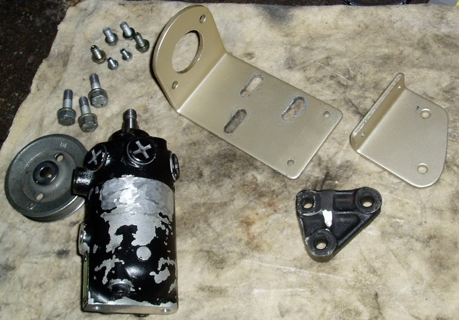

Hey guys, has anyone dealt with the p/s issue while going 24v in the 75/gtv6 chassis? I'm asking because I'm doing just that these days and this is he reason the 24v isn't in the car yet. I decided to use the original 75 p/s pump from the 4cyl engine. These are the same pumps used in 3liter cars but with a slightly different pulley. I wanted to mount it in the same place as with the 12v engine and keep the existing pipes, but I had to make up a special bracket for the job. Conveniently enough, there are 3 tapped holes (M10x1.25mm thread) on the side of the 24v head, just behind the exhaust cam gear and right below the valve cover. There was a heavy iron bracket there originally (for the fwd alternator?) and I chopped it down to where only a triangle with 3 holes is left and I epoxied this to the head (sort of like a spacer to clear the cambelt). I then configured my bracket from 5mm thick steel plate and cut 3 mounting slots to fix it to the head with the original M10 bolts. Why slots? They serve for belt tightening. All in all, I think the result is a neat job, although it could be done with a one-piece bracket instead of a split one. At this point, I’ll leave it as is.
The only pump modification necessary for this application was to completely eliminate (grind off) the two mounting ears, as they interfered with the intended orientation inside the bracket, hindering access to the three 17mm-head bolts. The pump itself was rebuilt by changing the 7 internal O-rings. Seeing it looks crappy, I may repaint it with 2-part epoxy paint.

I guess it comes down to what one likes, which is always subjective. Since I had a few of these pumps lying around and I can also repair them (curing leaks with new O-rings) I went with this choice, keeping the same pipework. Looks much better today after I painted it! Pretty soon there won't be any excuse not to put the engine in the car, heheh, aside from the fact the exhaust man is gonna get rich ... :cry:
