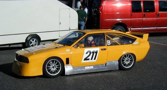

I checked my pics and I only have ones with the 16" tires on. They are exactly the same outer size, only the rim is 1" smaller.
GTV @ HGR01 a.jpg (31.37 KiB) Viewed 12259 times

Those are some serious side skirts...
I wouldn't be surprised if someone is hiding a BIG vacuum cleaner under there somewhere!! :lol:
