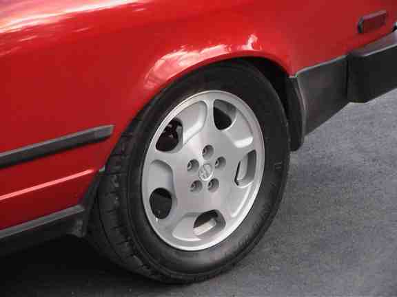

Will 164S wheels fit on Milano?
Post by Carl Friedman »
Bolt pattern is apparently the same. Will offset be an issue? Also, will hub opening fit, was told the 164 hub opening is smaller than Milano.

Post by SamW »
Slightly more offset than original, they will work if you bore out the center just a bit, I have heard it is not much. I have seen 164s wheels on a GTV6.

Post by Murray »
Carl they fit just fine>i use 164S wheels for my track tires and they are excellent - light and strong.As Sam said the only mod is you have to take a Dremel to the center-bore I can't recall the difference but the 164 is slightly smaller.Takes a couple of minutes per wheel.Offset is fine.

58.6mm on the 75, 58.1mm on the 164. So 0.5mm difference.
