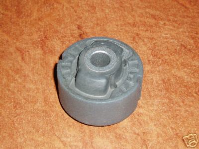

SZ RZ De Dion Bush Original
Post by ALFA GTV6 GP »
SZ original De Dion bush to suit the V6 Alfa Romeo's. OE ref is 0060533942
International auto parts sells all the bushings look here http://www.international-auto.com/pdf_f ... /IAP49.pdf
