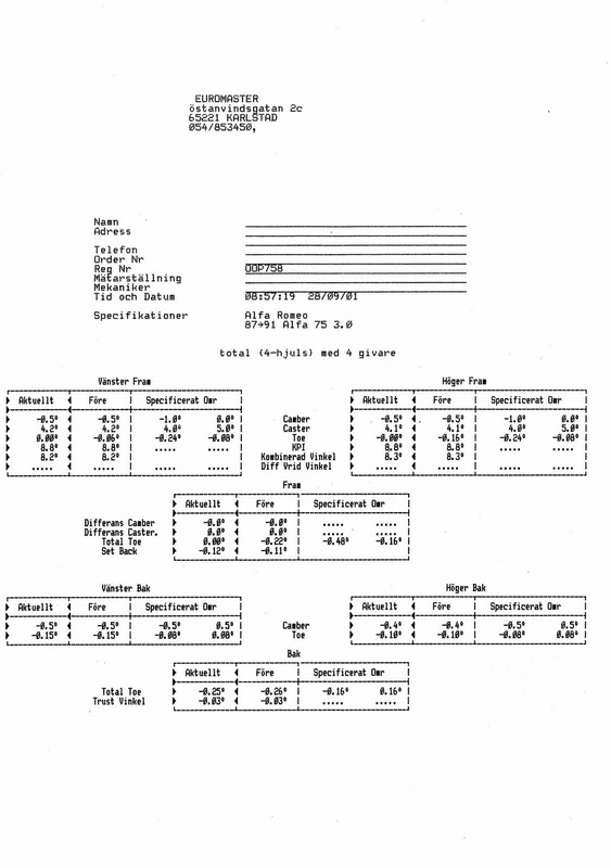

Same as for me then. This is a protocol for my car when i still used it on the streetsMerrilGordon wrote:When I had alignment checked, each rear wheel had -0.5 degrees camber. I don't remember what the toe setting was.
Merril
Edit: sorry, some text is in swedish but ithink you guys can sort it out.
Fram = front, bak = rear, aktuellt = present, före = before
- DOC050728_001.jpg (145.29 KiB) Viewed 14543 times
