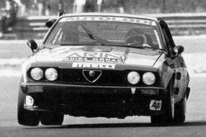

Please take a look at the first two photos and tell me what you see.I'm currently running Shankle 27mm front sway bars stock torsion bars and new Koni Yellows adjusted at about 50%.Rear is Shankle 25.? roll bars Shankle springs and Koni Yellows at 50%.Looks to me as if the inside front wheel is trying to lift ? This sickness I'm smitten with calls for constant improvement.Would larger torsion bars flatten the front end out? Coilovers are not an option as I don't want to change class.Perhaps I need to lose more weight ?

I see a rather nice GTV being driven like they should be.
Quite a lot of roll but you need to give us some more info.
Tyres? street stuff or slicks with threads (Yoko 032R or similar)?
What are the tracks like in the UK, smooth or bumpy?
Weight of car, power?
What do you use the car for? Is it a streetcar that you do some racing with or is it a serious racing car that you can't (legally) drive on the street? Looks like the latter because I can't see a rollcage and there is something that looks like an interior.
Forget shocks, they have nothing to do with roll.
Roll bars are for fine tuning, not as a substitute for springs.
Get the biggest torsion bars you can find and try to match them with a set of springs, can you change to 60mm springs in your class rule? That would help, much easier to find the right spring.
You can get it somewhat right by calculating frequncies for front and rear, the rear should be a little softer (lower frequency).
Make the car as low as you can according to your class rules or without bottoming out.
All this will of course destroy any type of street driving capabilities but if you want to be fast on the track...
Or just say "fukc it" and get a good set of tyres and adjust some angles on the chassis and drive it like you stole it without worrying about leaning over.
A good seat is always good and helps you relax, get one.

With that body roll you need -7 deg static camber....
What options do you consider realistic?
If coil overs are out then this would be my agenda:
1) lose weight as much as you can
2) Get stiffer torsion bars. The original ones are way too soft
3) When you install the torsion bars you can lower the car as well
4) Get rear springs to match the torsion bars
5) As you're at it adjust the wheel alignments
After getting through this you will discover a totally new car to drive.

Hi Murray,
Your inside front tire is trying to lift off the planet. This is common on cars with stock torsion bars a big sway bar and good tires. The only real fix is to stiffen the front suspension with stiffer torsion bars of a coil over set up.
That said, your car looks really great going around corners!

you can't really lose camber in a turn by just lowering the car, the camber-gain curve is somewhat constant as long as the legths and mounting points are the same.
You will however get bump steer (and therefore roll steer)

Thanks for all the solid comments guys ! I use this Alfa on the street as well so I'll be conservative.I think I'll start with one size larger torsion bar.All in all I'm very pleased with this car's handling and probably being able to unload the inner front a bit is just a reflection of how well this machine is sticking to the track.My racing is just for fun and I'm sure I can realize far greater reductions in lap times by improving the quality of the device installed in the driver's seat.I'm probably not even using 75% of this car's capability with its existing setup !
I must be honest when I say that for a reletivly stock setup your car looks very good through here.How was your turn in,mid corner and exit(apex)attitude of the car??(Understeer,4 wheel drift,oversteer etc)
The unloaded front wheel has a lot to go before lifting at all.I believe that you will understeer before lifting any wheels.
