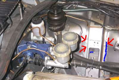

hello...
i want to rid of the torsion bars.
planning for the rs setup for the end of the year.
the car is a pure fun car, runs on the street for the fuel pump only, and often the times on track days.
does anybody had photos of reinforced fenders ?
i guess some welding beetwen inner fender and shock mount chassis frame :?
+ a renforcing upper bar.
look in the photo from a other car, about the solders points.
opinions ?

Paul Bird wrote:If you use the colovers without torsion bars the car will not respond correctly
Paul.UK
wasn't that Ron simmons says me...
also...car is welded...(only on front)
around front fenders and shock mounts.
i hope for a weigth loss of 30kg with tube welded A arms and RS coil overs.

Post by zambon »
If you weld any panels in the engine compartment be sure to use TIG welding. Arc welding will weaken the thin sheet metal in the area, defeating the purpose of the modification.
I have seen other photos where they didnt weld the whole seam, instead they alternated. A few inches welded, a few unwelded.
I am not sure if this is the correct aproach. I surmised that it was to keep from making the front end too strong and therefore dangerous in a crash.
tectoteam
Posts: 188
Location: south FRANCE
Post by tectoteam »
exactly.
30 mm welds, and 30mm beetwen each.
