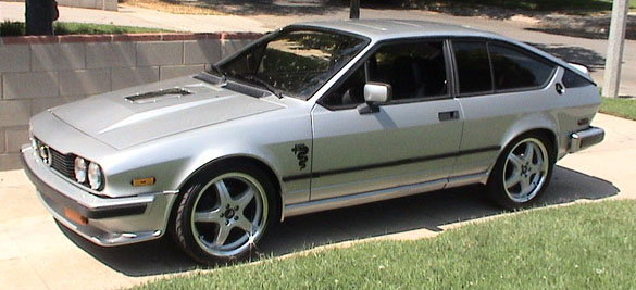

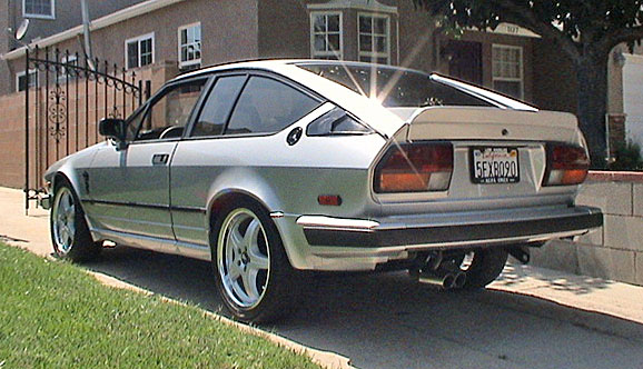

Tim, my the new Serpent Autosport Type 3 wheels are 17x7 with a 40 mm offset. Tire size is 215/40/17 on the front and 215/45/17 on the back. They do not rub at all and the ride is nice and handling is right on.
GTV6 front side web306.jpg (70.53 KiB) Viewed 13306 times
GTV6 rear side web.jpg (95.88 KiB) Viewed 13309 times

Wow, that looks really nice! I love it.

Charlie! sorry dude for the non relpy... I some how missed your post. Your car look BRILOES dude. Choice wheels there. Mines a silver as well. No where as tidy as yours tho.

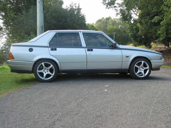

I think a nice 5 spoke wheel looks great on the GTV6's .
Heres mine on 17" MAK Stings. Offset is Subaru.

That looks really nice, my 75 is on MAK Stings aswell, although only 16" x 7.5".
Atm the tyre profile is too large and makes the car look jacked up, but next time round I'll be getting lower profile for sure, and wider too.
