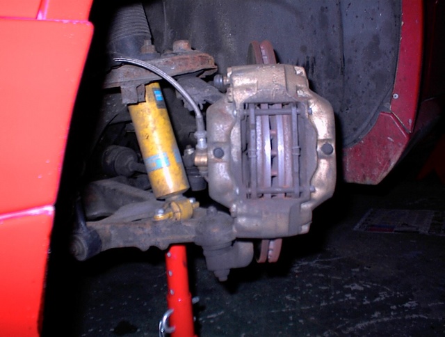

Hmm, that sounds weird, exactly the opposite to all my Bilsteins and all other I've ever seen.
I'll dig up a pic too. ;)

This s an old pic of my front susp. Still, Bilsteins are mounted with the piston rod poiting upwards 8)
Kenth Wiklund

In Maurizio Picture the wider side attaches the a arm and in Kunta's picture its the opposite :?
What about those rear ones ? any marks from factory pointing the correct direction or what ? the rear ones are those who can trick you if not marked, not the front ones, at front shocks you cant go wrong!
