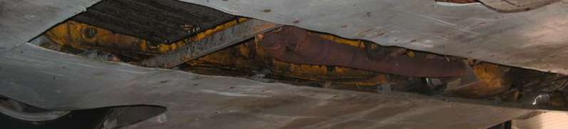

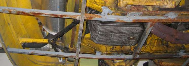

Without getting into the issue whether you need strengthening or not, I'll give you my 5 ct.
Without welding there's not that much to do. As increasing the body torsion stiffness requires "3D strengthening" only bolting something in the bottom plane will not help even close to a simple cage.
However, as you want to do what's possible there's something fairly simple which you can do just by bolting. I have basically the same even if mine is welded and not done to strenthen the car (just a pleasant side effect).
Make suitable square tubing under the car from the front of the longitudinal beams. Take them all back to the DeDion crossmember. The bigger the section of the tube the greater the effect. It will protect the bottom and the exhaust as well.
While you're at it you can use the tubes to attach a flat bottom
If you like you can bend the tubes slightly and take them all the way to the back of the car (under the DeDion). Dunno how good this will fit on a road car though. Of course you can take them to the front spoiler as well....
One warning though. When you start and get carried away, I can tell you that with all them welded beams and plates under the car it is not very service friendly anymore
