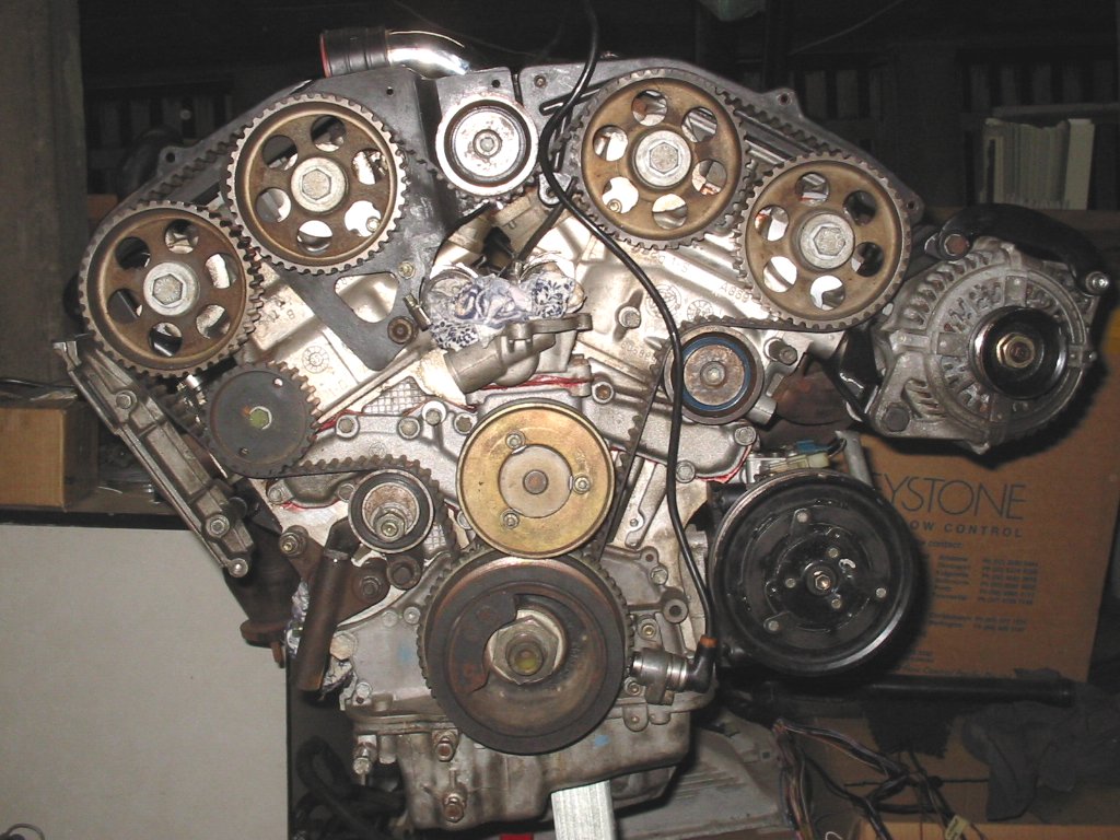

Very few 164s in the U.S. have 24 valve motors. I am fairly certain that one is a normal 12 valver.
If you look at the engine you will see 2 cams per head if its a 24v
Scott

I do not think I have ever seen an Alfa 3.0l 24V engine. Can anyone post a picture so I can tell on sight what I am looking at.
I am assuming one would want the 24v if they are going to undertake the swap so I just want to make sure I don't make an error on the picking out of the engine.

Ok, I looked at the 3.0L conversion and it looks quite involved but not impossible. I would like to have an engine just in case I go this route. If I read the thread correctly the engine that was installed was a 3.0l 12V and it looked similar to my 2.5l engine. So I was still hoping to know how to get a 3.0l 24V or a picture of one. What type of cars do these engines come from. Only in UK, HK. I would want to get one in USA if possible. Looks like Greg thinks that one that I maybe able to get is a 3.0l 12V. Are the valve covers different? If I get the serial number of the 91 164L can I referrence from here?

the # of 24v 164 qv that came to the US is very small; i want to say like <1000 (good luck finding them!).

24v is easy to pick because it has 2 cam wheels per head. I thought the 24v was first released in about 1993 / 1994 - only 12v until then.
1994 164 3.0 24v
1994 164 3.0 24v
24v in '84 GTV
24v in '84 GTV
23-07-06 007.jpg (236.95 KiB) Viewed 10837 times

Daniel,
Thanks for the picture of your engine. I really appreciate your help. How did you get your beautiful engine??

No 164 24v officially came to Australia, so I imported the engine in along with the 164 12v for my Dad's GTV. It took a while to find a 24v but it worked out cheaper than buying a local 12v at the time.
I know a guy who has a '99 GTV V6 (24v) for sale. It only has about 10 000 km on it from what I can remember, complete with everything.
Last time I spoke to him, he wanted about $4-5k AUD but I'm not sure how you go sending one of these o/s or the cost of freight.
There must be loads of 164 24v engines around but probably only in europe - that may be a cheaper import option.

Thanks again for the information on this thread since it helped me determine what a 24V looks like. Of course, from the pictures, it does say 24V on the plen. so I guess thats a no brainer too.
