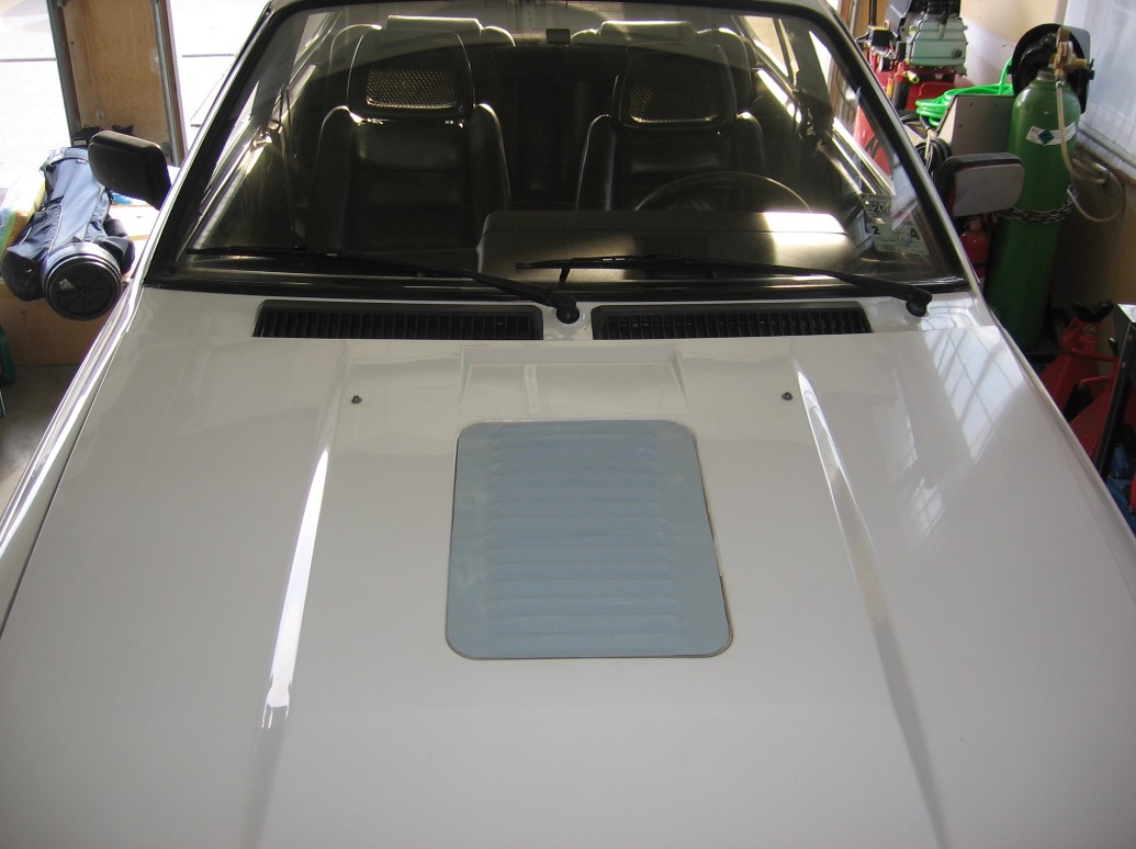

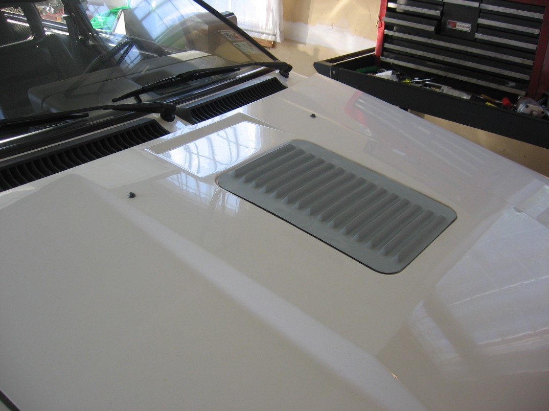

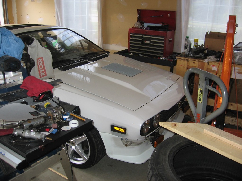

HOOD VENT PICS>>>
well here it is, and I must say, it looks pretty good...still in primer
will face rear, vents on top...have not decided how to attach it, probably big rivets
you can see the engine from the rear which is cool...

I like that a lot.
sweet! .....pics up for five minutes and a POSITIVE response!
Thanks, Greg
John in Denver
Posts: 47
Joined: Thu Dec 30, 2004 6:58 am
Post by John in Denver »
That not only looks good but it makes it appear that the (lets admit it) otherwise silly center section actually has a purpose.... which it now does!! I'd go for one of those.
sh0rtlife
Posts: 536
Post by sh0rtlife »
i like it ALOT...what about spot welding in some small bolts so it bolts in or fullt weld some studs onto it....pop rivits are just wrong
pancho
Posts: 159
Location: Melbourn 'e
Post by pancho »
I must say/agree that the plastic cover is the most silly apparently useless addition to the car.
PanchoRama
Still not sure about the look, may be the primer. What's the finish color going to be?
How about pop-nuts and some nice screws? :)
Good idea short and Mats....some 8mm ones like original or nice racing fasteners
color will match body....
