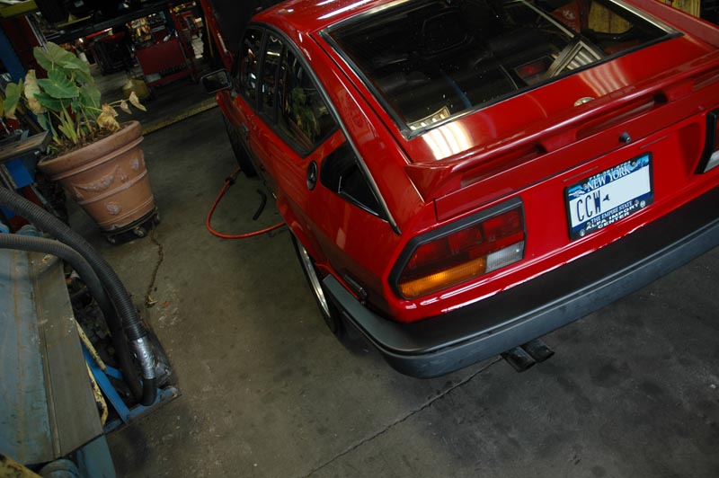

Post by nicke »
The EURO bumpers bolt right on, I just put a pair of them on my car. If you find them make sure you'll get all the brackets.
And the guy I got them from doesn't have any more of them...
Good luck, Nick
FrankG
Posts: 4
Joined: Sun Nov 28, 2004 4:35 pm

Post by nicke »
There's two smaller "U" shaped brackets for the front, that mates with the 4 screws that hold the impact shocks, these are screwed on with the front lifted up from the under-side. Remove the side plastic covers and mate to the screw that the US style bumpers slide out from, the dirctional lights have only two wire connectors, since the Euro cars dont run the blinkers as driving lights.
For the rear there's 2 more "J" shape brackets that mount the same way as the front, exept that the "rubber" has to be off and they're screwed on from the rear, the same on the sides.
If you find a set of bumpers, be extremely careful remowing the "rubber" part, since it has to come off to mount them, and you don't want to break any pins...
Good luck, Nick
P.S. For my race car project, I'd love to fit a 75/Milano EVO style fron bumper/splitter, Possible? Anyone?
Rear euro bumpers mounted... Note lack of ugly cover plate...
