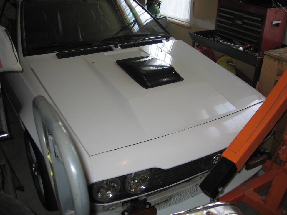

Got the Summit scoop...vacuformed plastic but pretty nice piece..about 1/16th thick...pics below
scoop is almost perfect for the hole...just a little too tall
As for the rain issue...there is no issue...its always sunny when I drive my Alfa :wink:
forward
forward
hood 004.jpg (112.01 KiB) Viewed 9659 times
backward...
backward...
hood 006.jpg (104.89 KiB) Viewed 9658 times

:idea: How about using the same plastic panel you have now and cut louvers into that..? You retain original look, and you wouldnt notice the louvers till you got right up close..? Thats something that i will be doing if i dont come up with anything else, but i definatley dont want a scoop. :!:
Selling 1985 GTV6.
It would be hard to cut louvers into the plastic..too brittle...and if I cut out a hole in the panel for the louvers, I might as well just use the metal margin already on the metal louver and just trim it to fit in the original hole....use the same mounting holes, etc...
actually, scoop doesn't look that bad in person and better if painted...
right now, the hood looks like a giant squinting Snoopy

cant say i could ever like that scoop..too tall and gives the car a modern rice trashy look to it :roll:
