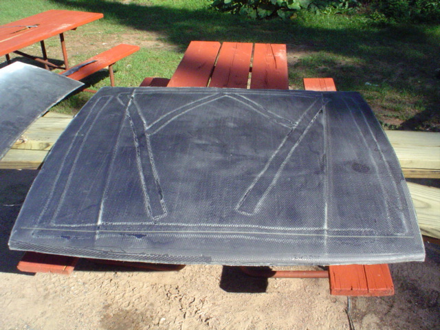

I finally made a trunk lid for my Milano. It was my first time using the mold, so the result left a bit to be desired. I had to add a bit of filler and glaze to smooth out the surface. It was also my first time pulling from a mold of that size. My vacuum pump proved to be a bit weak for the task, due to the size of the project.
I am currently working on a second pump. I hope that I will be able to get a nicer finish with more vacuum. Once I get that sorted out, I will make a hood.

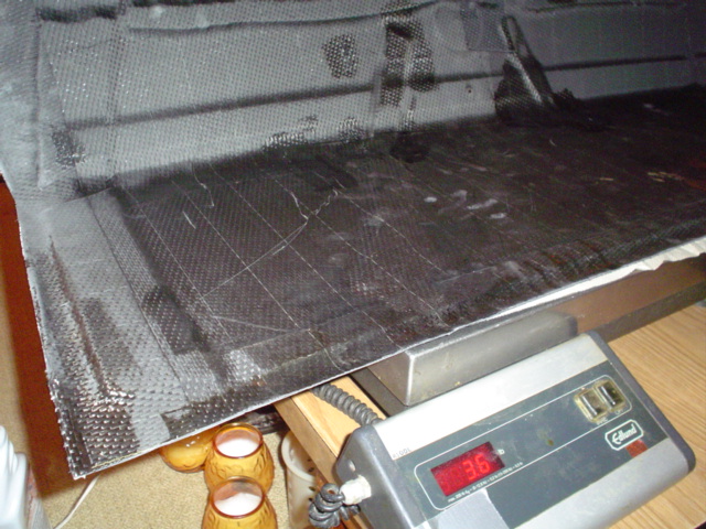

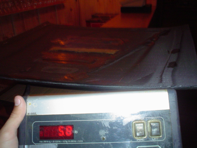

The trunk lid is constructed from carbon fiber with kevlar cloth and kevlar honeycomb as a core. The result is very stiff. This thing will not be flopping down the road.
I have not trimmed around the outside of the part yet, but even so, it is shockingly light: 3.75lbs!

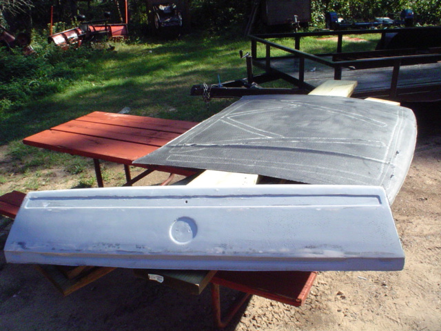

Here are some photos of my hood and trunk. They are now roughly trimmed, but unfinished. They will need some filler and paint before installation.
