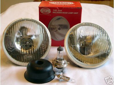

Shopping around for an inexpensive way to upgrade standard light to H bulb series, I found these and bought 2 sets, about 30$ for one side
Look at
http://item.express.ebay.com/5-3-4-H500 ... xpressItem

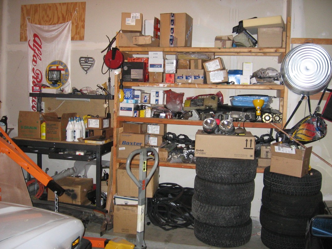

Required Alfa parts spares...
lights 001.jpg (243.83 KiB) Viewed 4104 times

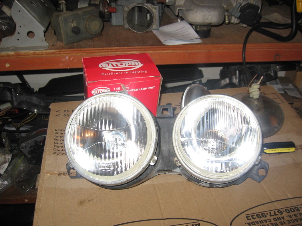

new light in BMW housing..easily adjustable
lights 002.jpg (189.03 KiB) Viewed 4106 times

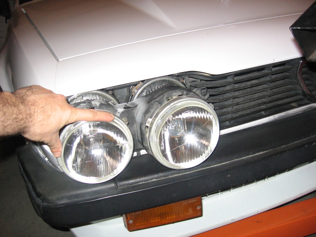

Preview of the new 'look'...slightly different spacing and lateral lamp depth..but no big deal..have new BMW chome surrounds, too..(can't find at the moment...)  Bug Eye Alfa?
